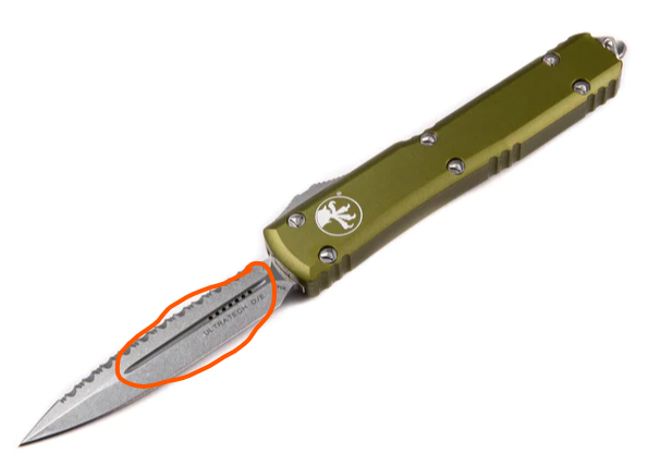

Daggers and stilettos can be tricky to clamp in the vise. The trick is to clamp them on either a flat section of the blade or in the fuller (groove). If your dagger or stiletto doesn't have this feature, it may not be possible to clamp that blade.
