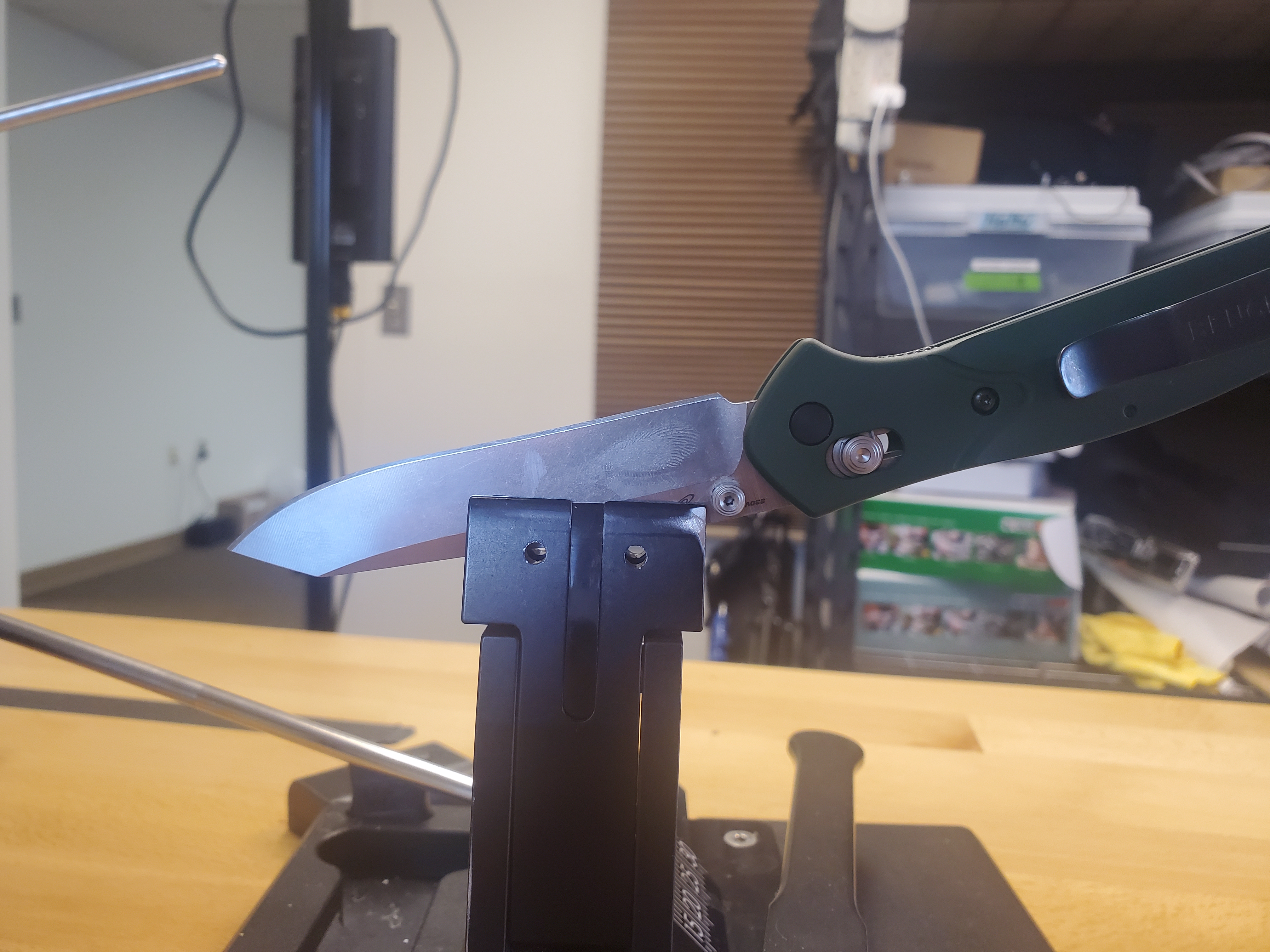

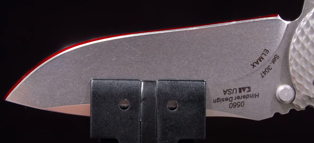

To begin this process, you'll take a Sharpie, place it down directly on the edge of the blade, and run it down the length of the blade so both bevels are colored in.
Next, you'll take your highest grit Diamond Stone and lay it against the knife, adjusting the angle until the stone appears to lay flat against the bevel of the blade. Increase your angle by 2 degrees. It's always better to start at a slightly wider angle than you need to prevent scratching the body of your blade. Do several passes with your stone on one side of the blade to see where the marker is being removed. We are only looking to find the angle at the moment, not the sweet spot. You'll find that you will most likely bounce back and forth between finding these during this process, but the first order of business is the angle. When finding the angle, simply focus on just the section of the blade that sits directly above the vise itself.
If you're seeing the marker only being removed at the edge of the bevel, but not lower on the shoulder, it means your angle is too wide and you need to lower it. Do this in 1-2 degree increments to prevent scratching the body of your blade.
If you see the marker only being removed at the shoulder, but not the edge, your angle is too narrow and you need to increase it. Again, do this in 1-2 degree increments to ensure you get the correct angle.
Repeat this process on the other side of the blade. Once you found the angle and have removed all the marker from the section above the top of the vise, you can move on to finding the sweet spot. To find the sweet spot, you'll want to look at how the marker is being removed along the entire length of the blade, not just a single section. When thinking about how to move your blade when finding the sweet spot, you'll want to think about moving the knife toward where the stone is hitting the edge. If the marker remains on a section of the edge, it means the stone cannot reach it and you have to bring the knife to where the stone can reach.
If you're finding that you're removing all the marker from the blade except for on the shoulder at the tip of the blade, that means your knife is clamped too far back and you need to move your knife forward in the vise.
If you see that the marker is remaining at the edge at the very tip, your knife is too far forward.
For most knives, the first time you sharpen them you'll have to move them several times and adjust the angle as you move the blade until the majority of the marker is removed. Very rarely is the angle consistent along the length of the blade and even more rare will you find that you remove all the marker from the edge on a new knife, even if you have found the correct angle and sweet spot. The trick is to find the positioning and angle where the most marker is being removed. Once you find that, you can use a coarser grit to reprofile and even everything out.
