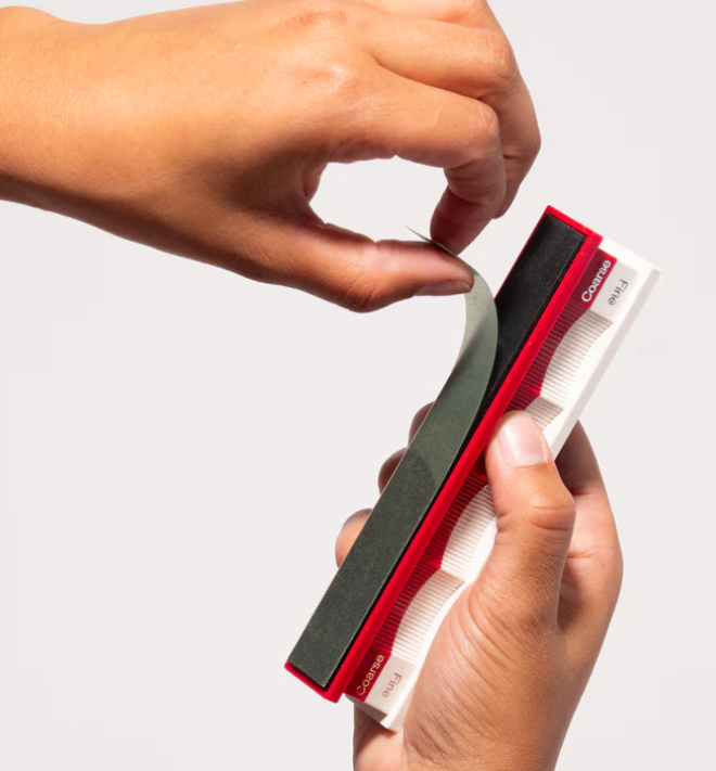

How to Apply Lapping Film
To use Lapping Film, simply peel a strip off the sheet and stick it to the platen. Center the strip as much as possible. That's it!

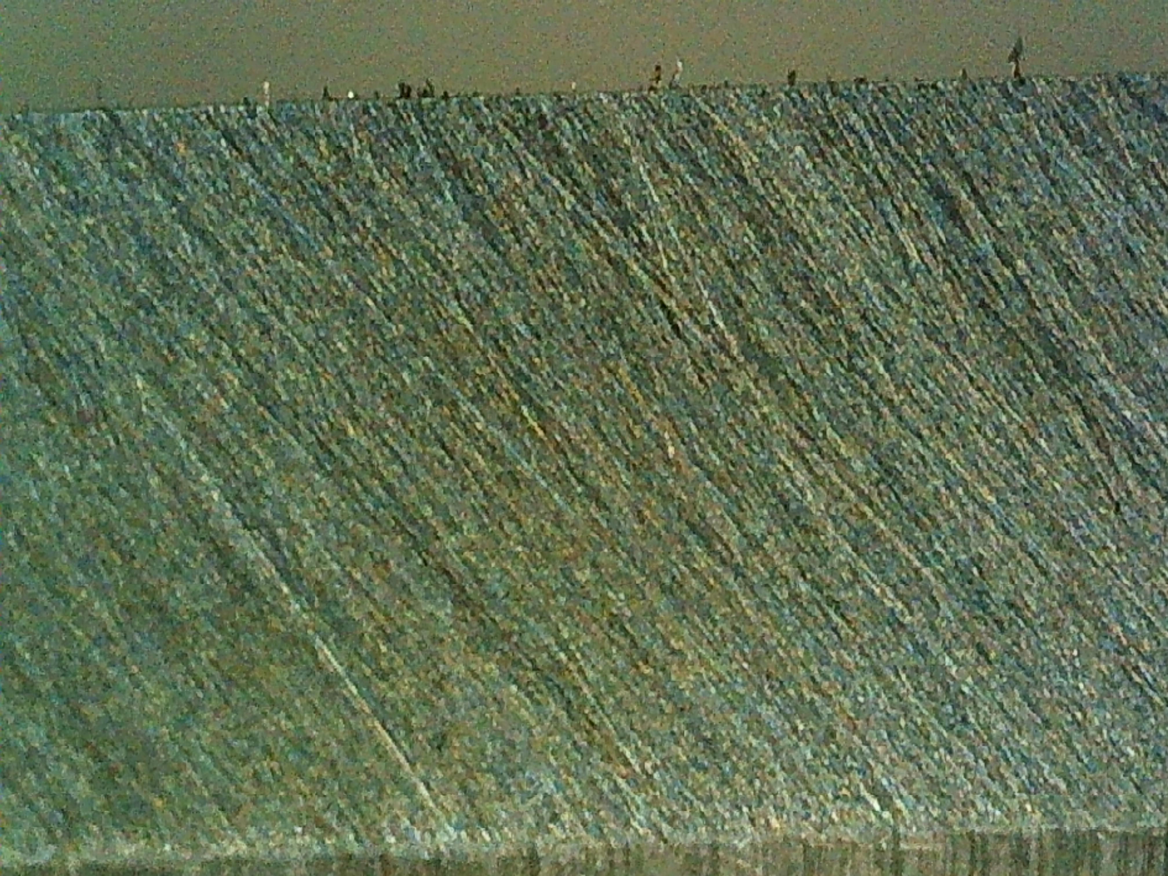

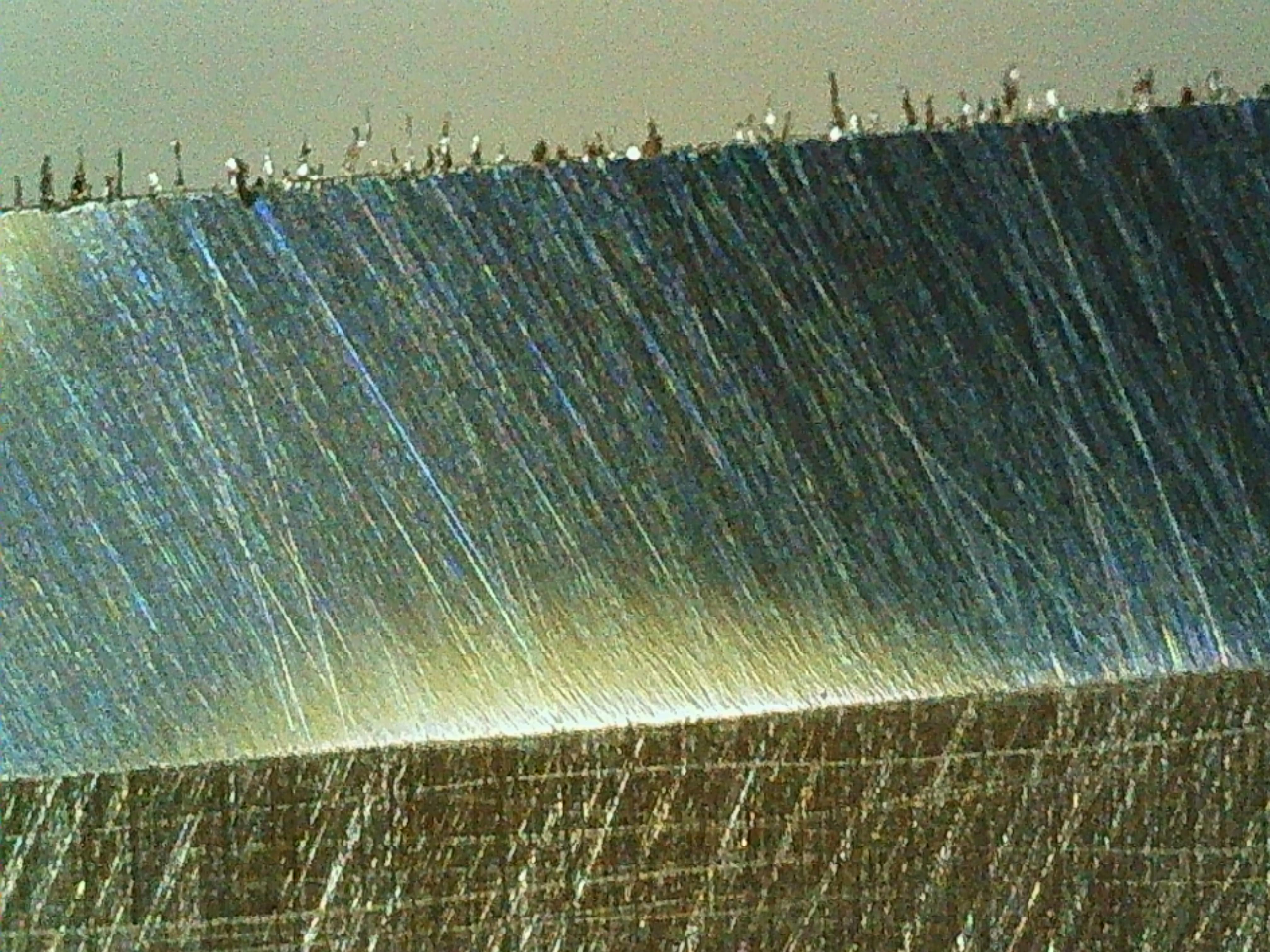

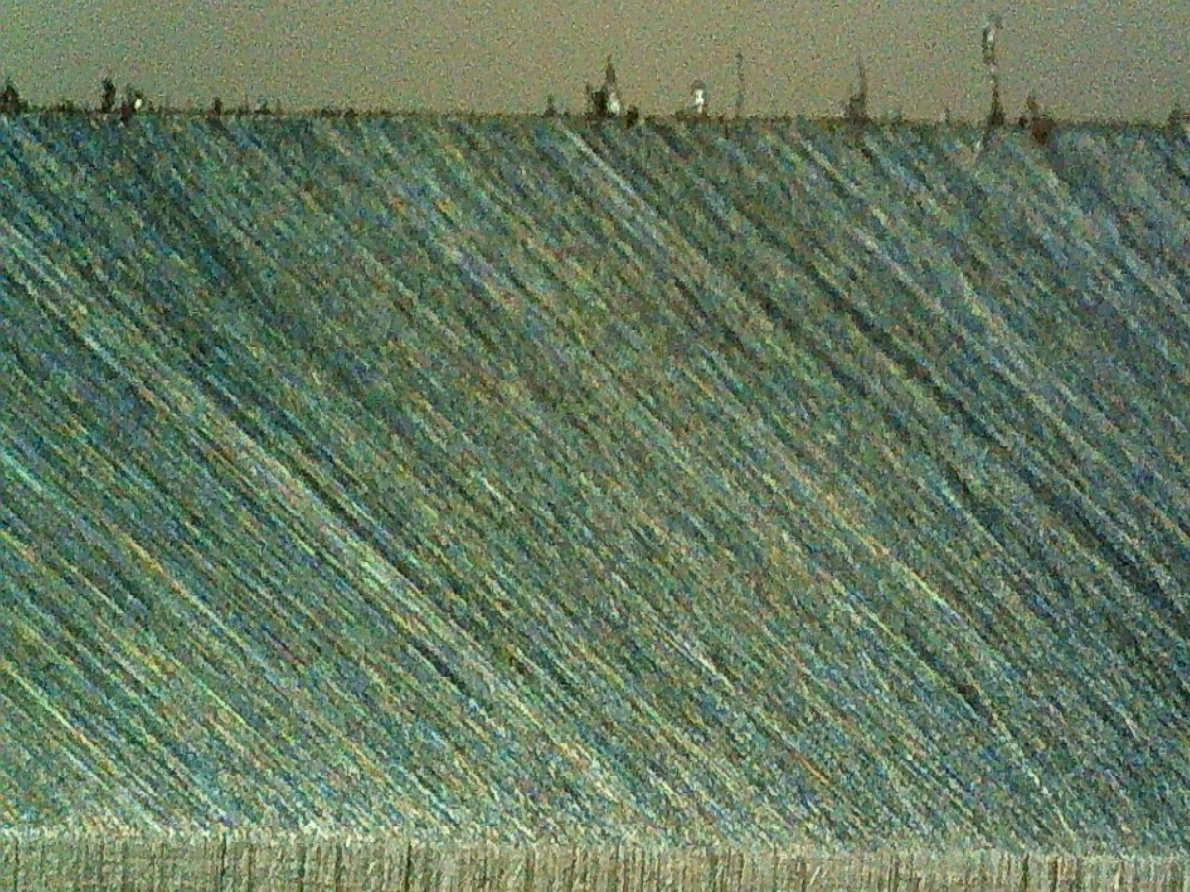

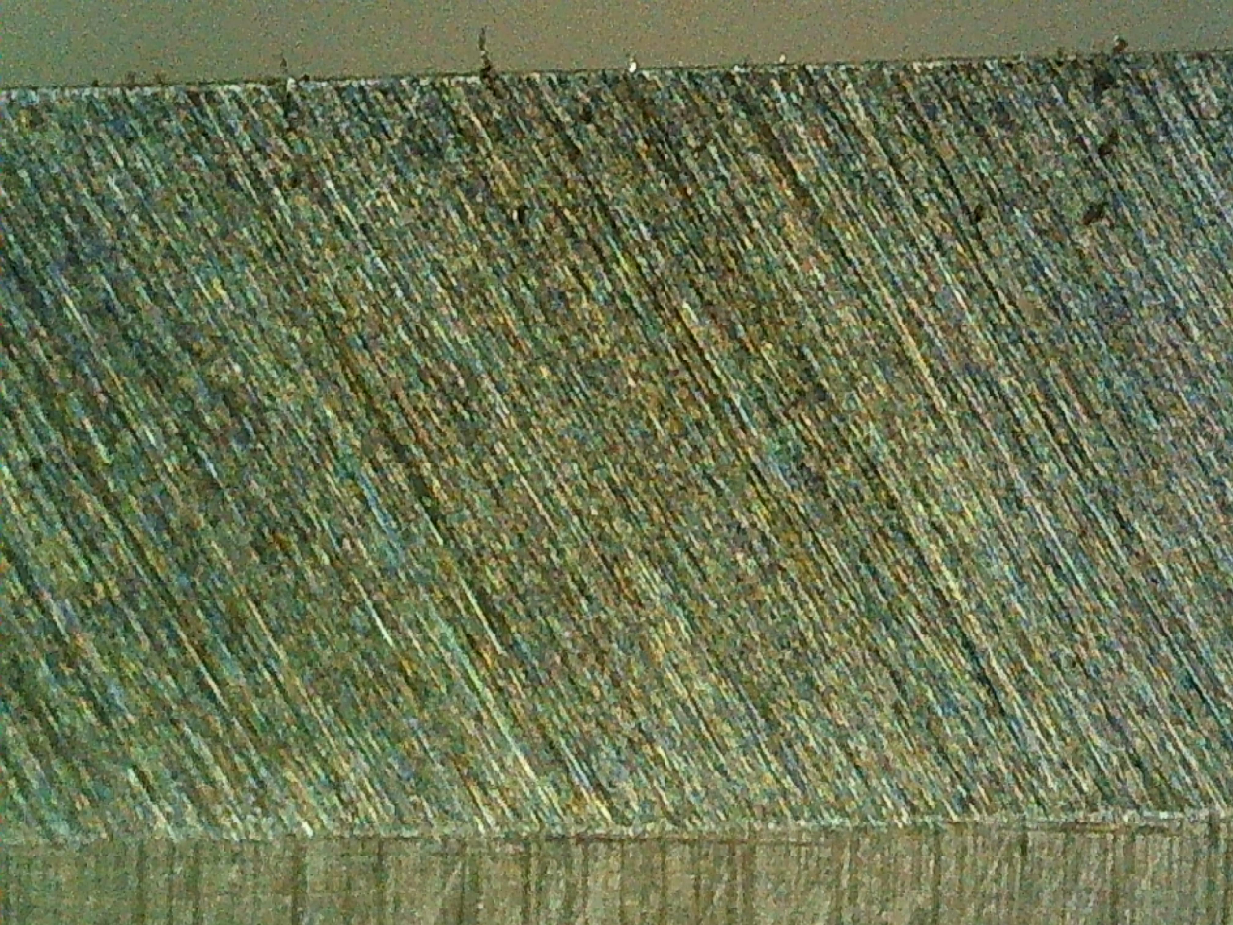

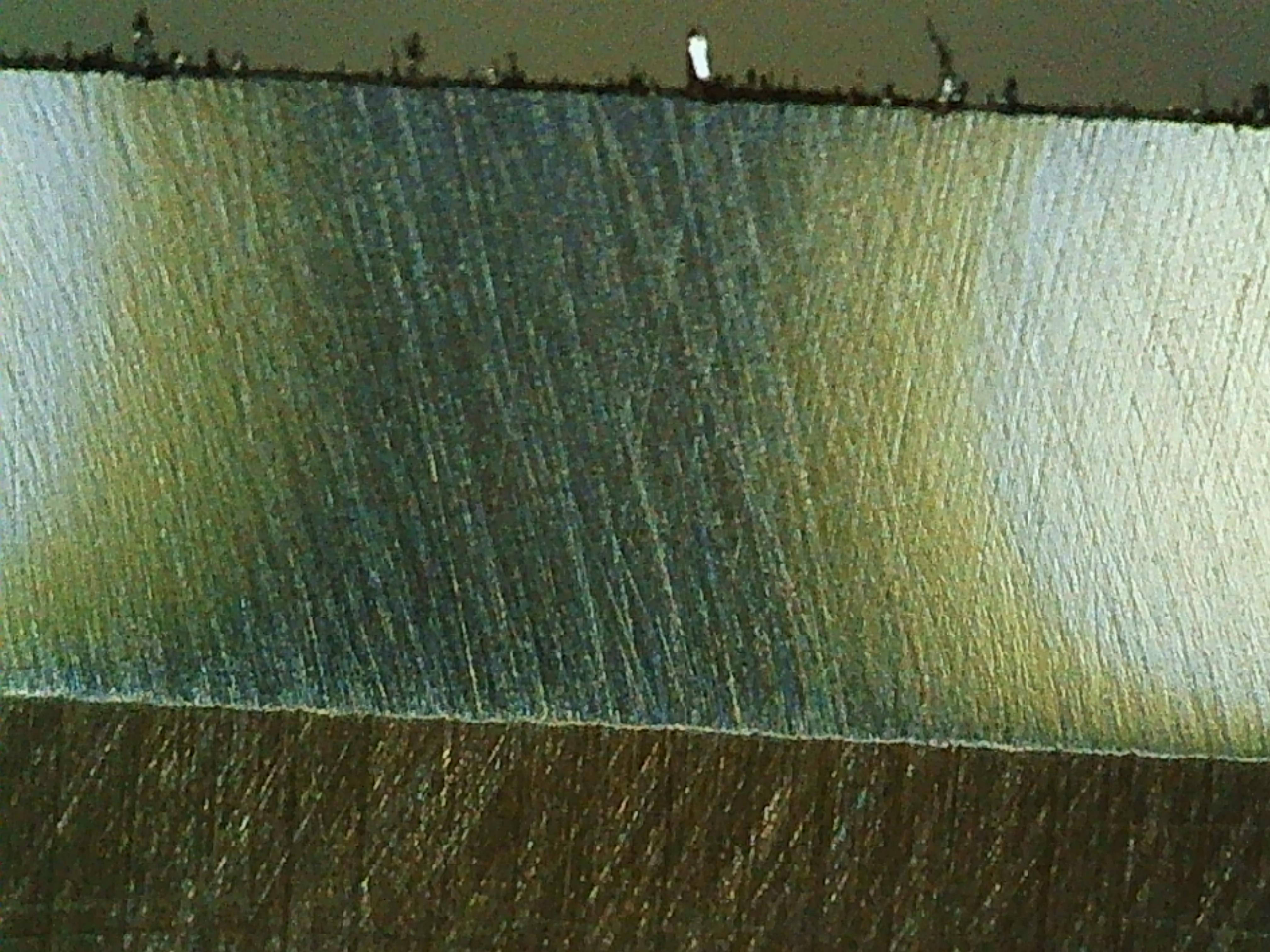

Image of Edge Finish (M390)
30 Micron
Initial Lapping Film for creating a convexed edge. Follow with 15 Micron Lapping Film

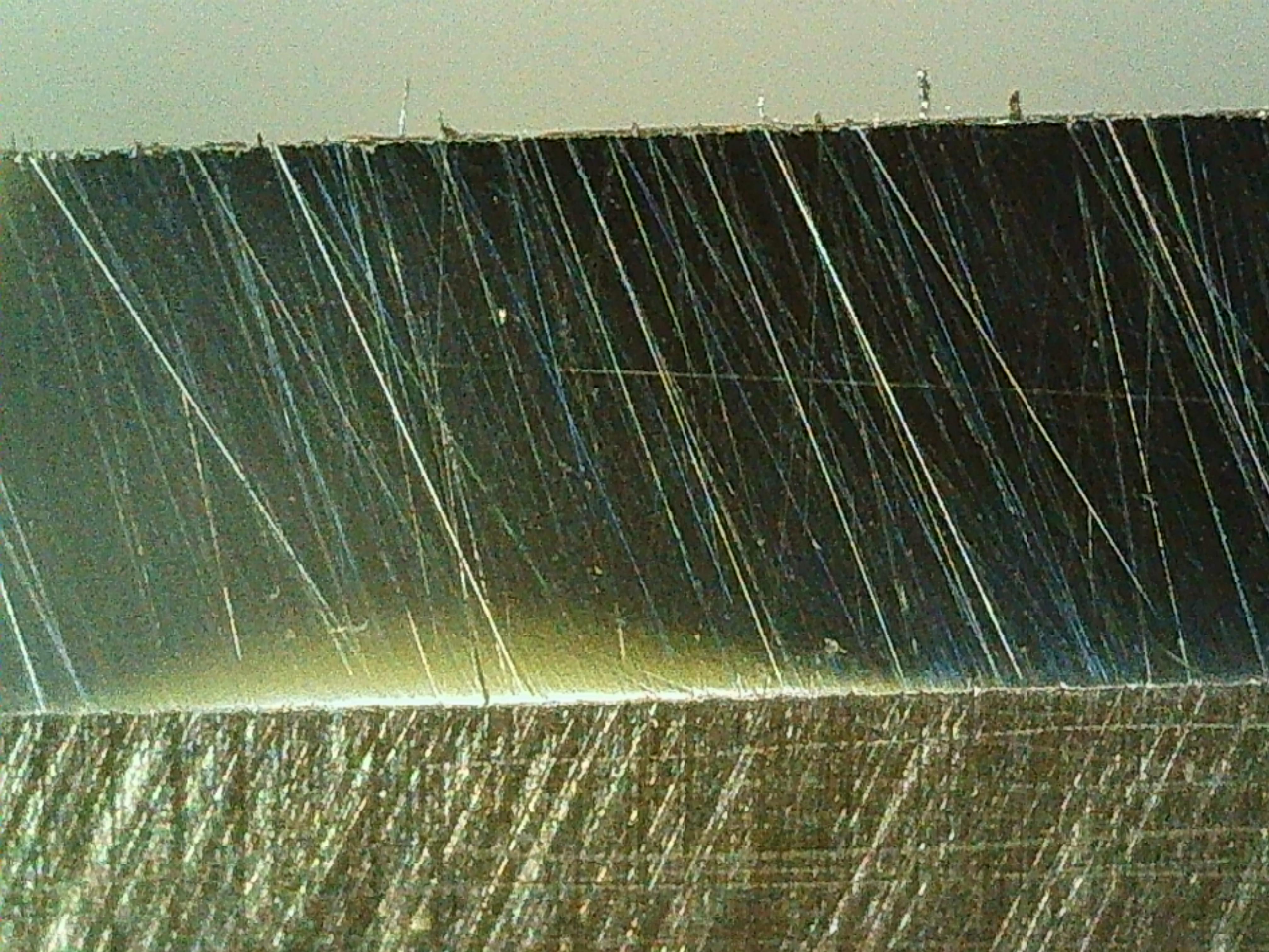

15 Micron
Use after 30 Micron Lapping Film when creating convexed edge - produces edge similar to 800 grit Diamond Stone. Follow with 9 Micron Lapping Film
9 Micron
Use after either 1000 Grit Diamond Stone for v-grind or 15 Micron Lapping Film for convexed edge. Follow with 6 Micron Lapping Film or 5/3.5 Strops

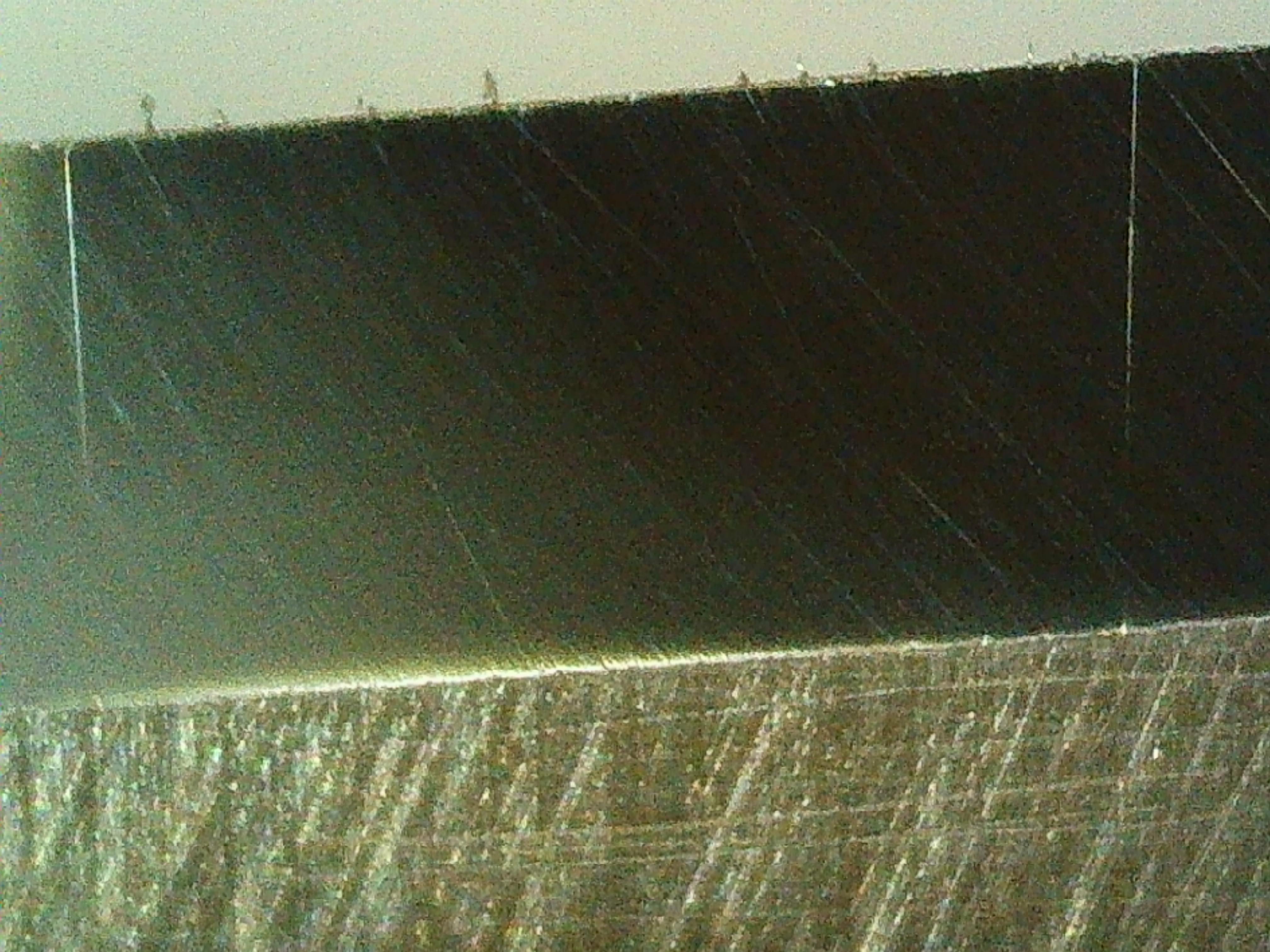

6 Micron
Use after either 9 Micron Lapping Film, 1500 or 2200 Grit Diamond Stone. Follow with 3 Micron Lapping Film or 5/3.5 Strops
3 Micron
Use after either 6 Micron Lapping Film or 3000 Grit Diamond Stone. Follow with 1.5 or 1 Micron Lapping Film or 4/2 Strops

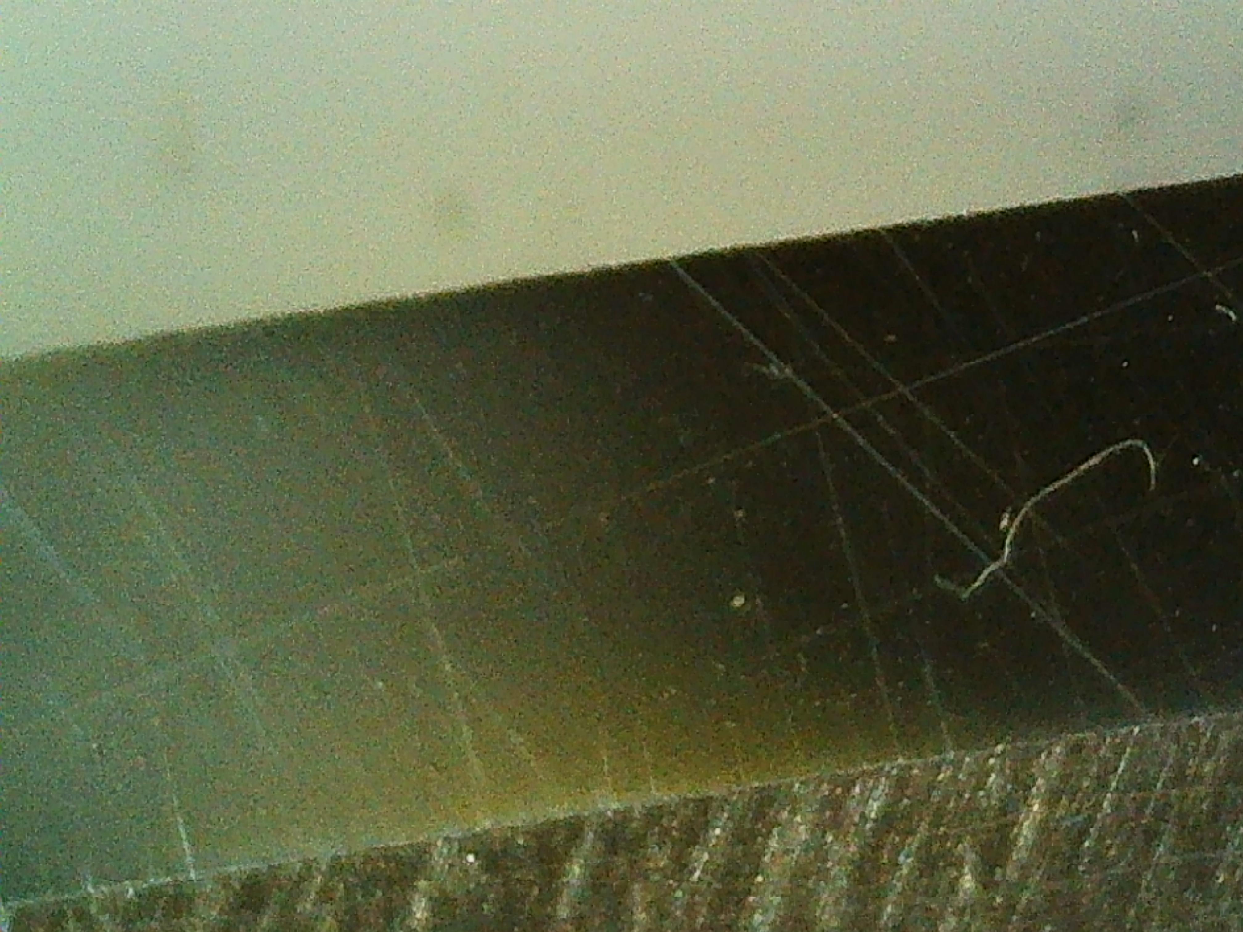

1.5 Micron
Use after 3 Micron Lapping Film. Follow with 1 Micron Lapping Film or 1/0.5 Strops
1 Micron
Use after 3 or 1.5 Micron Lapping Film. Follow with 0.1 Micron Lapping Film or 1/0.5 Strops
0.1 Micron
Use after 1 Micron Lapping Film. Follow with Kangaroo Strops, 0.25 and 0.1 Gunny Juice
