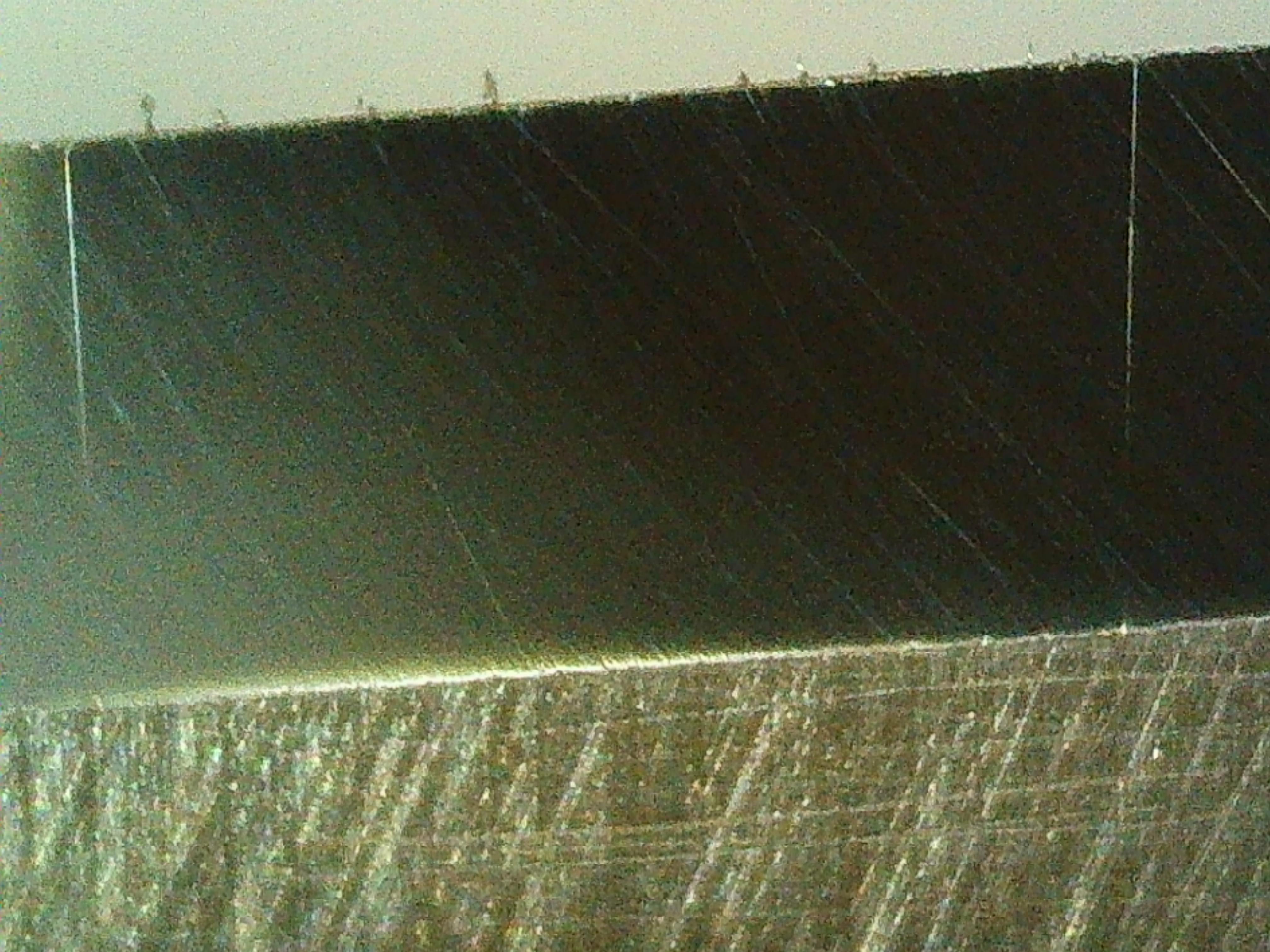

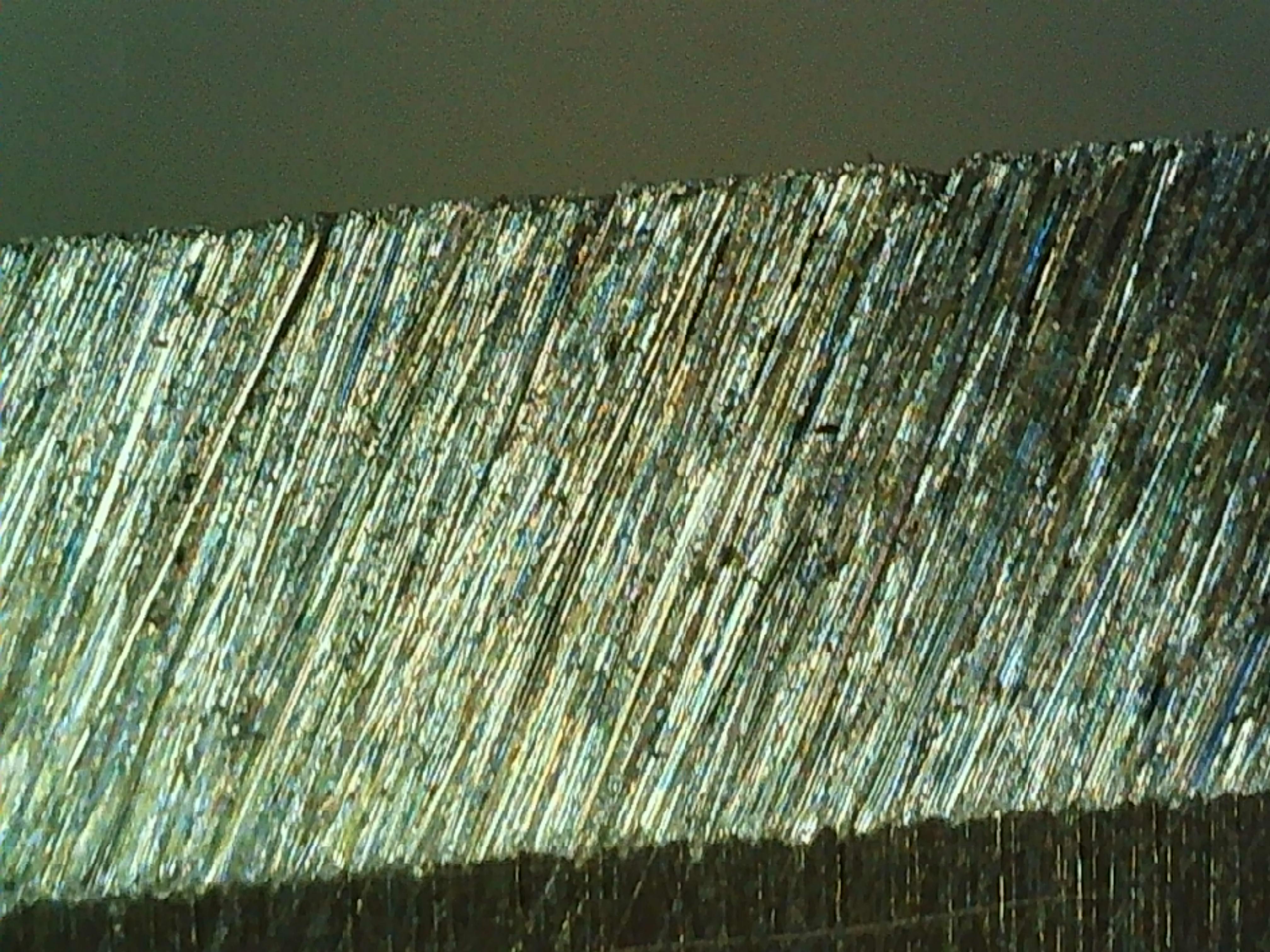

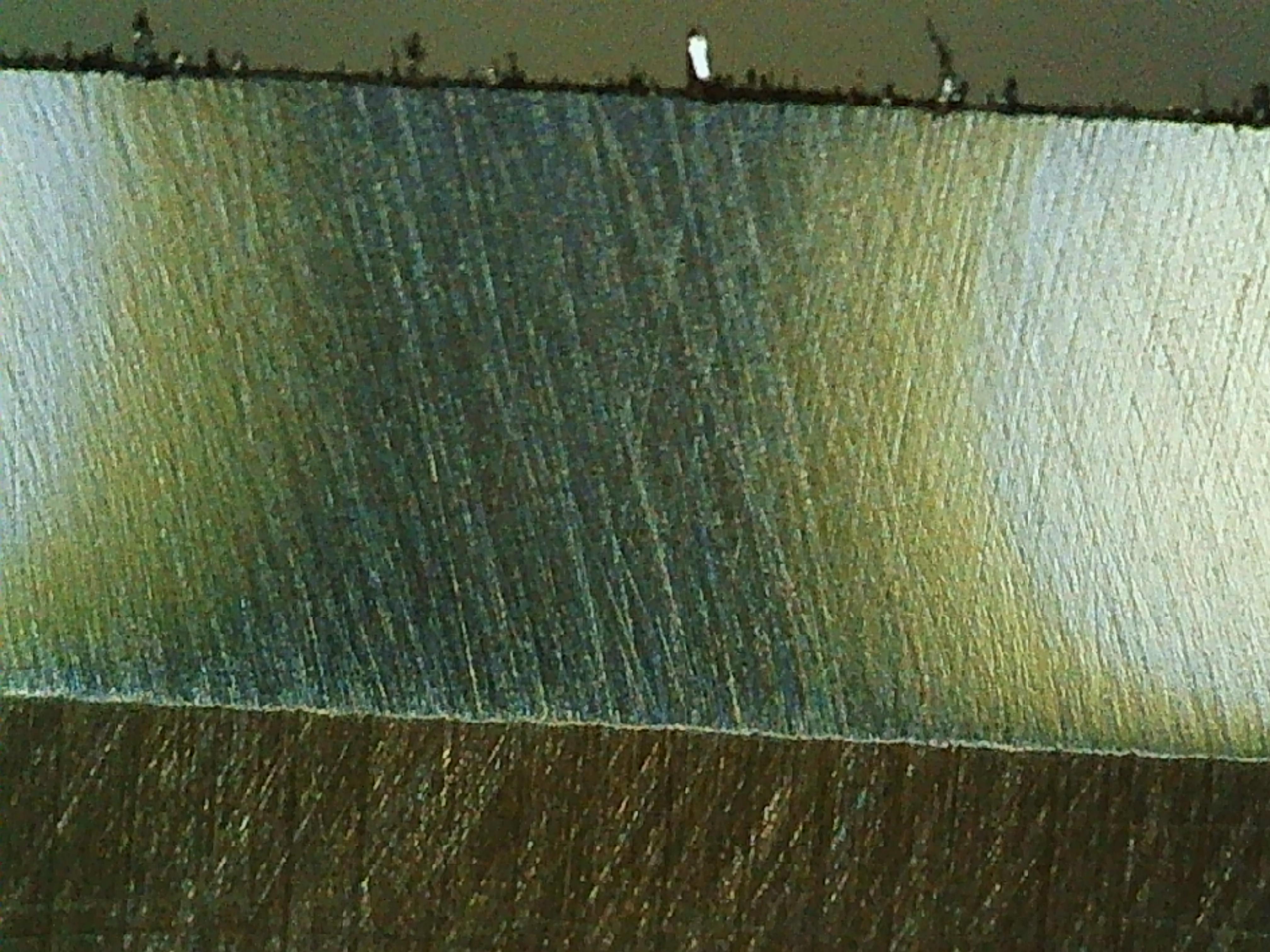

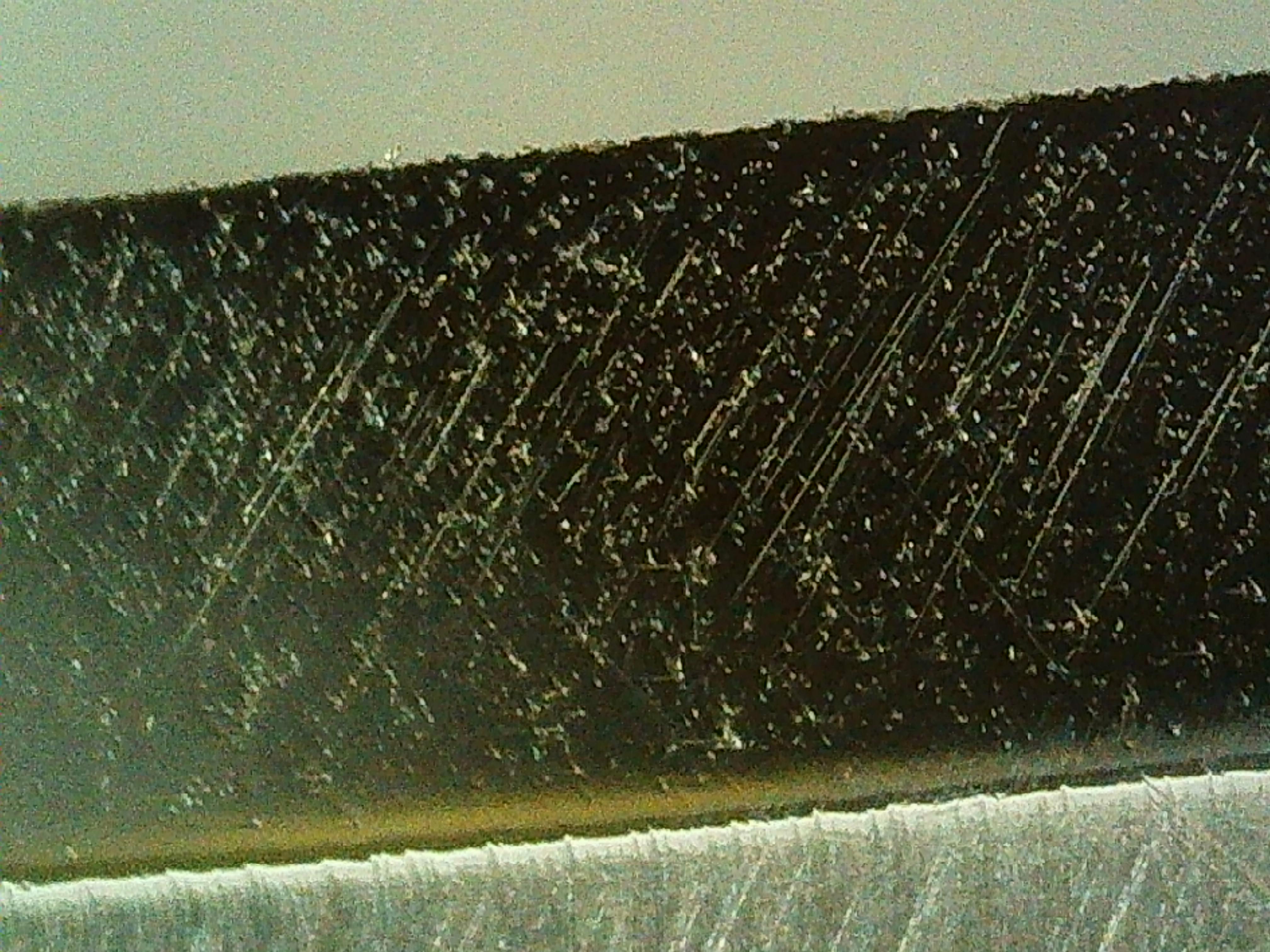

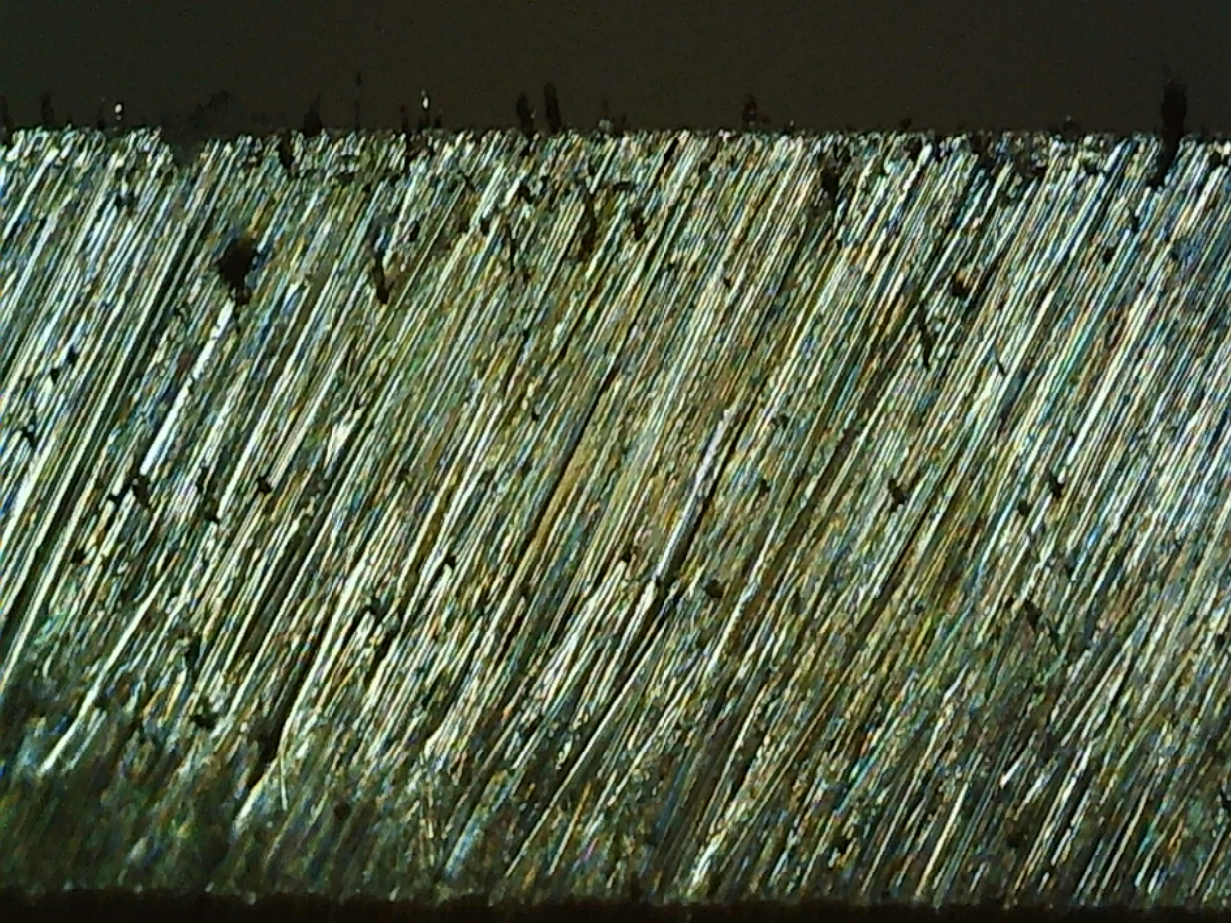

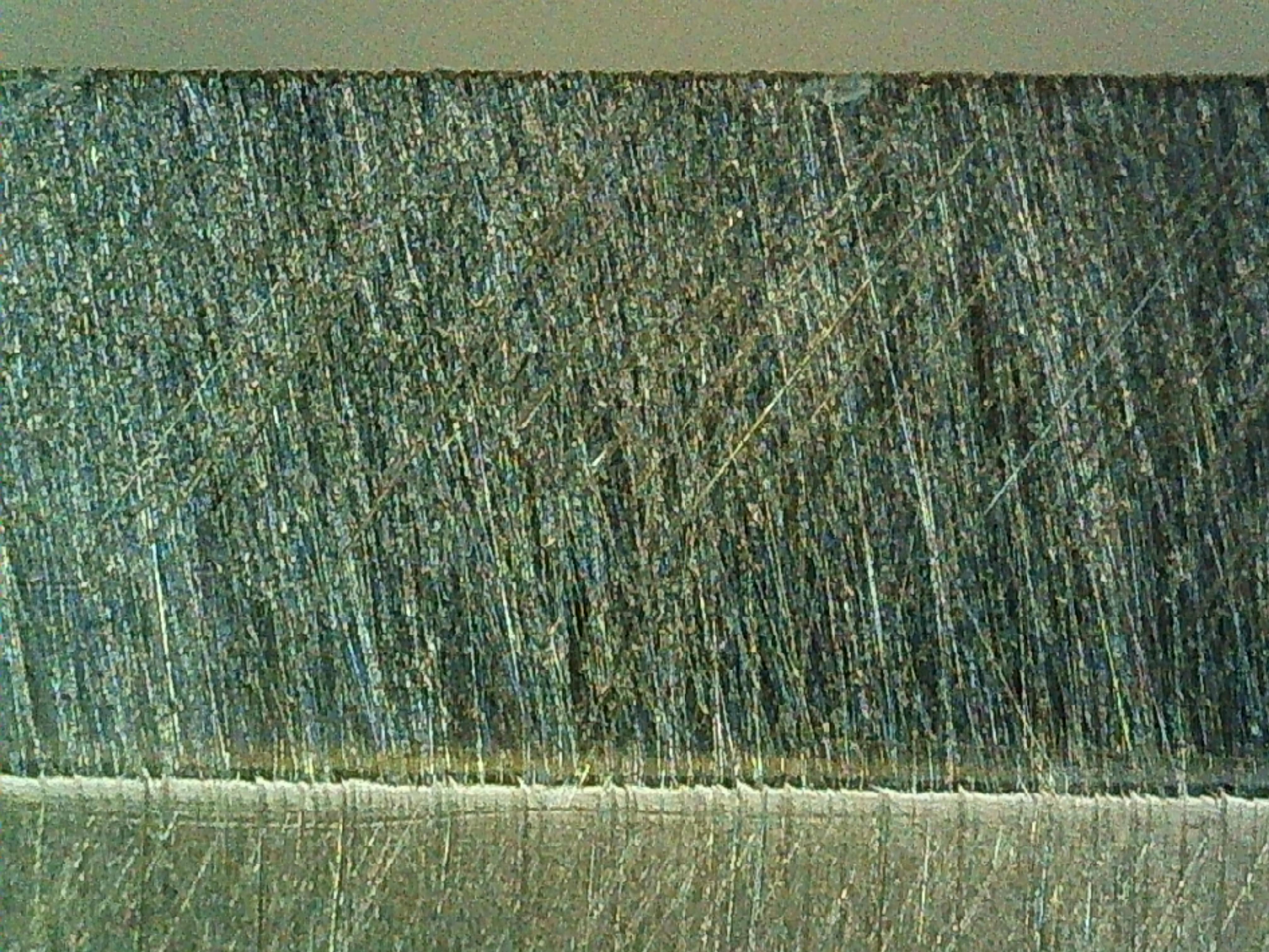

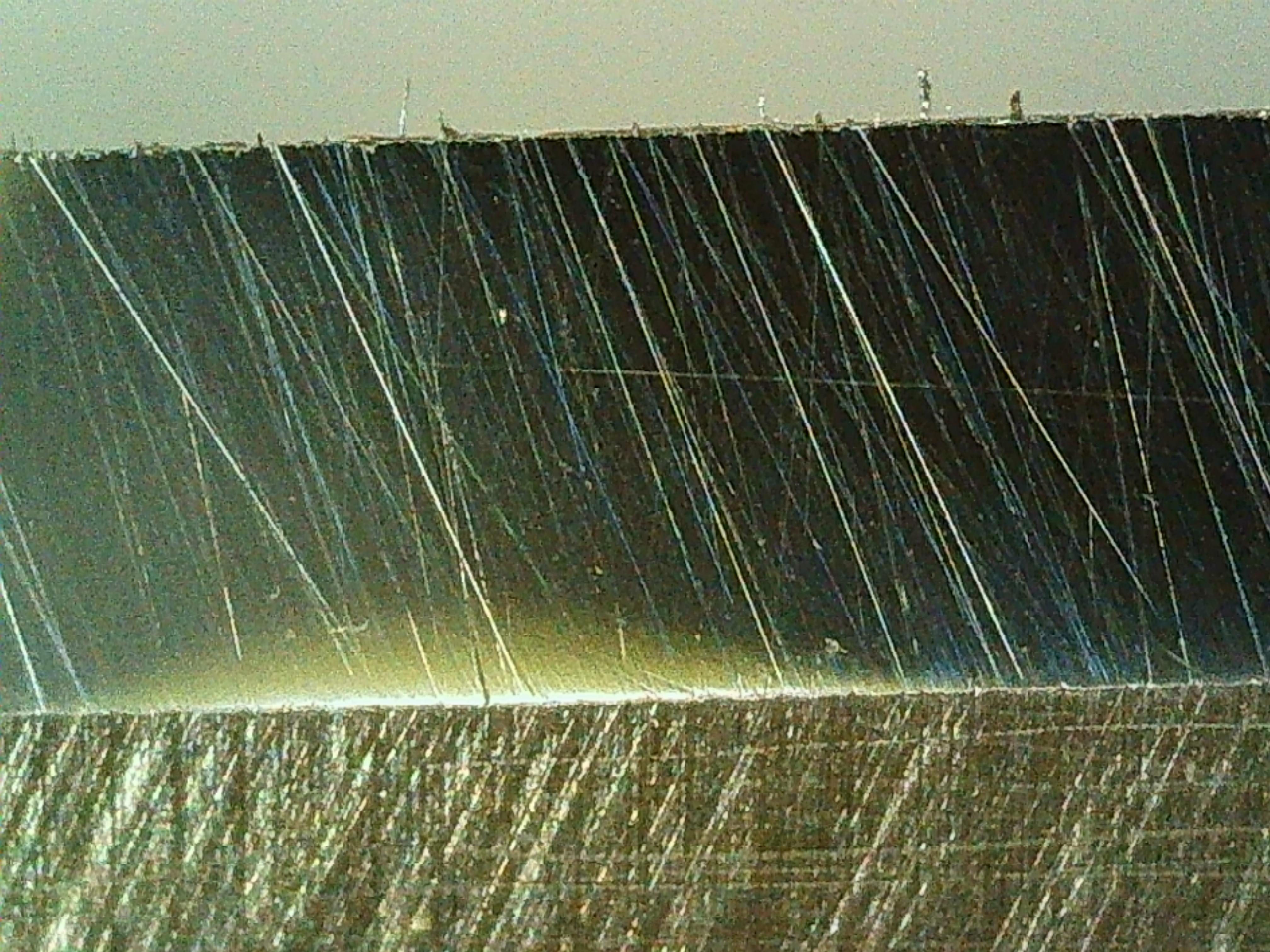

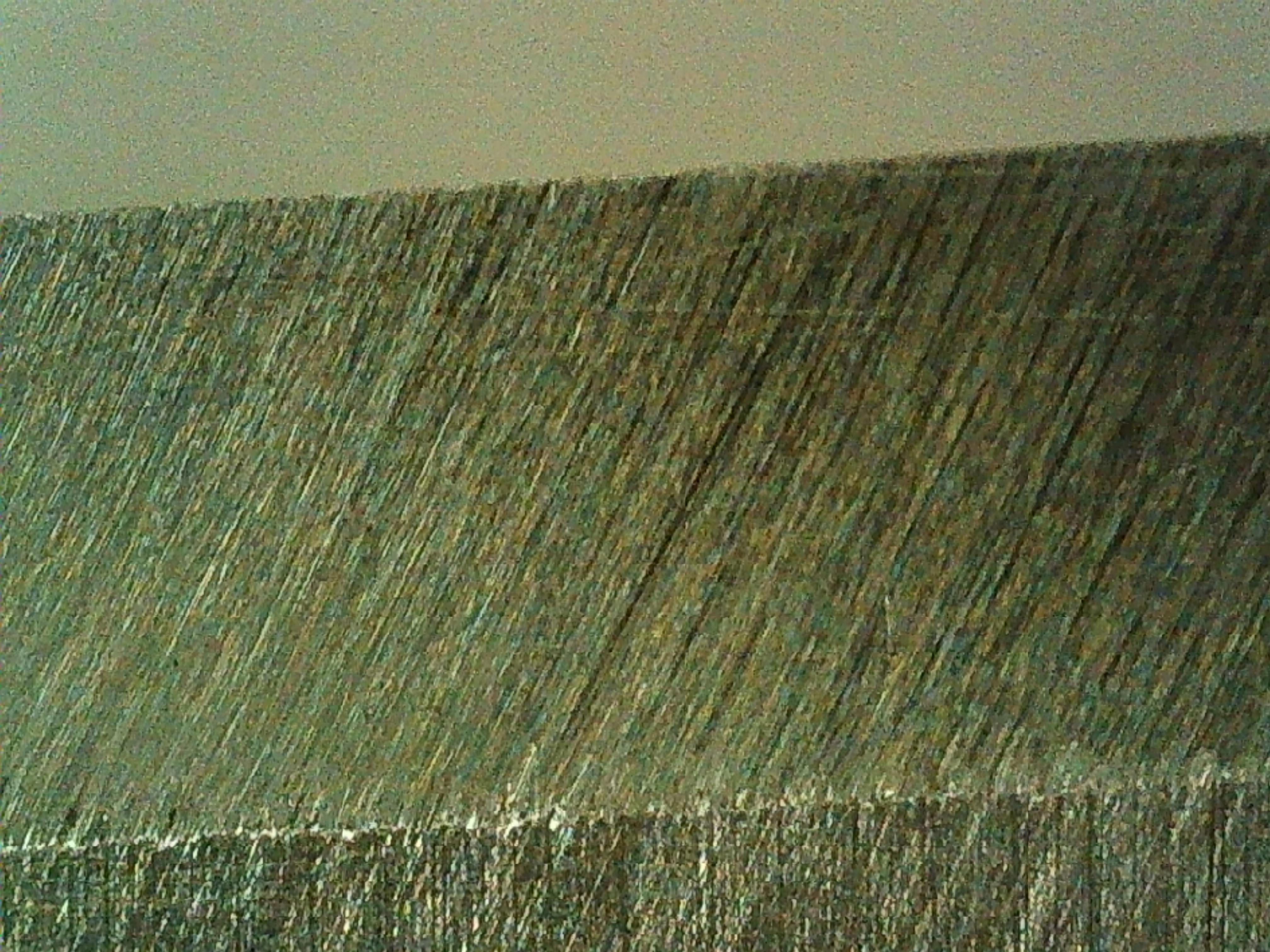

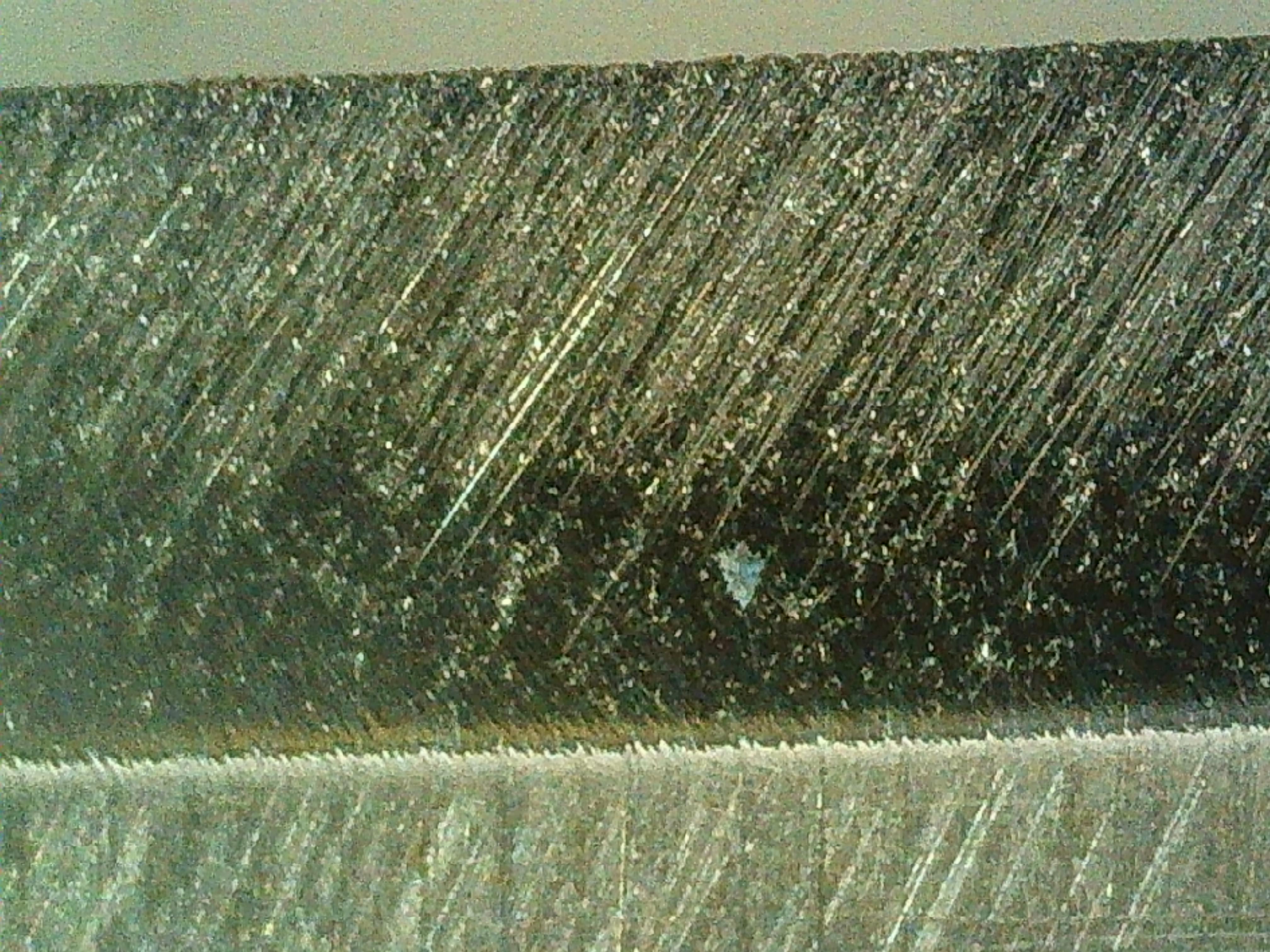

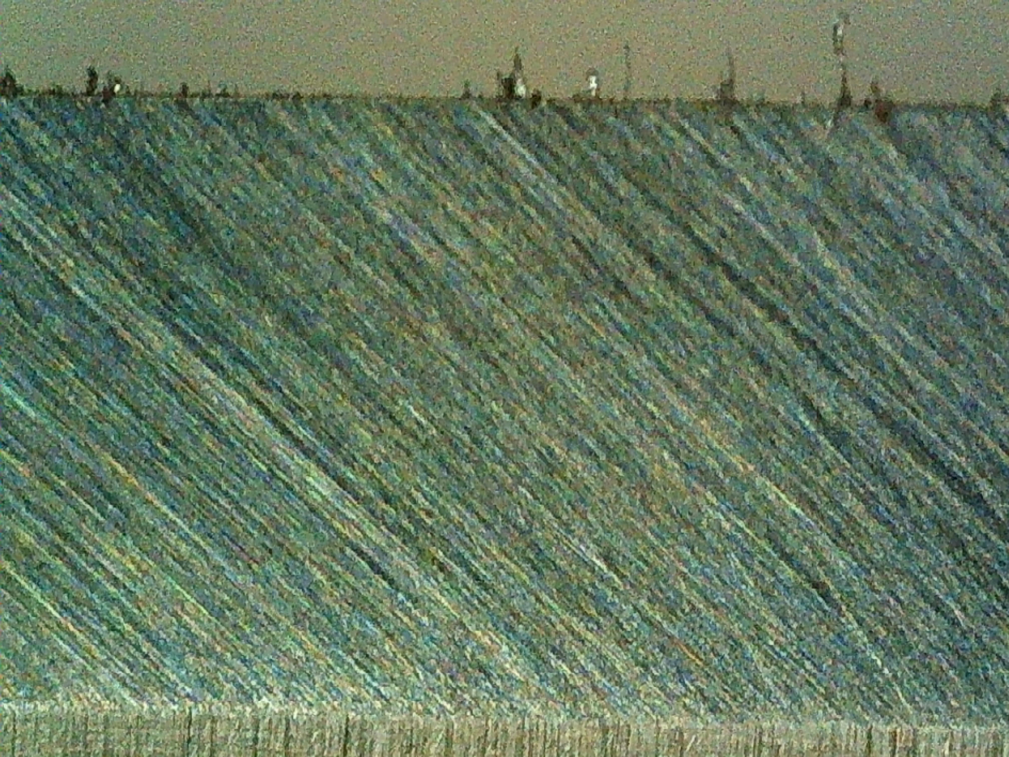

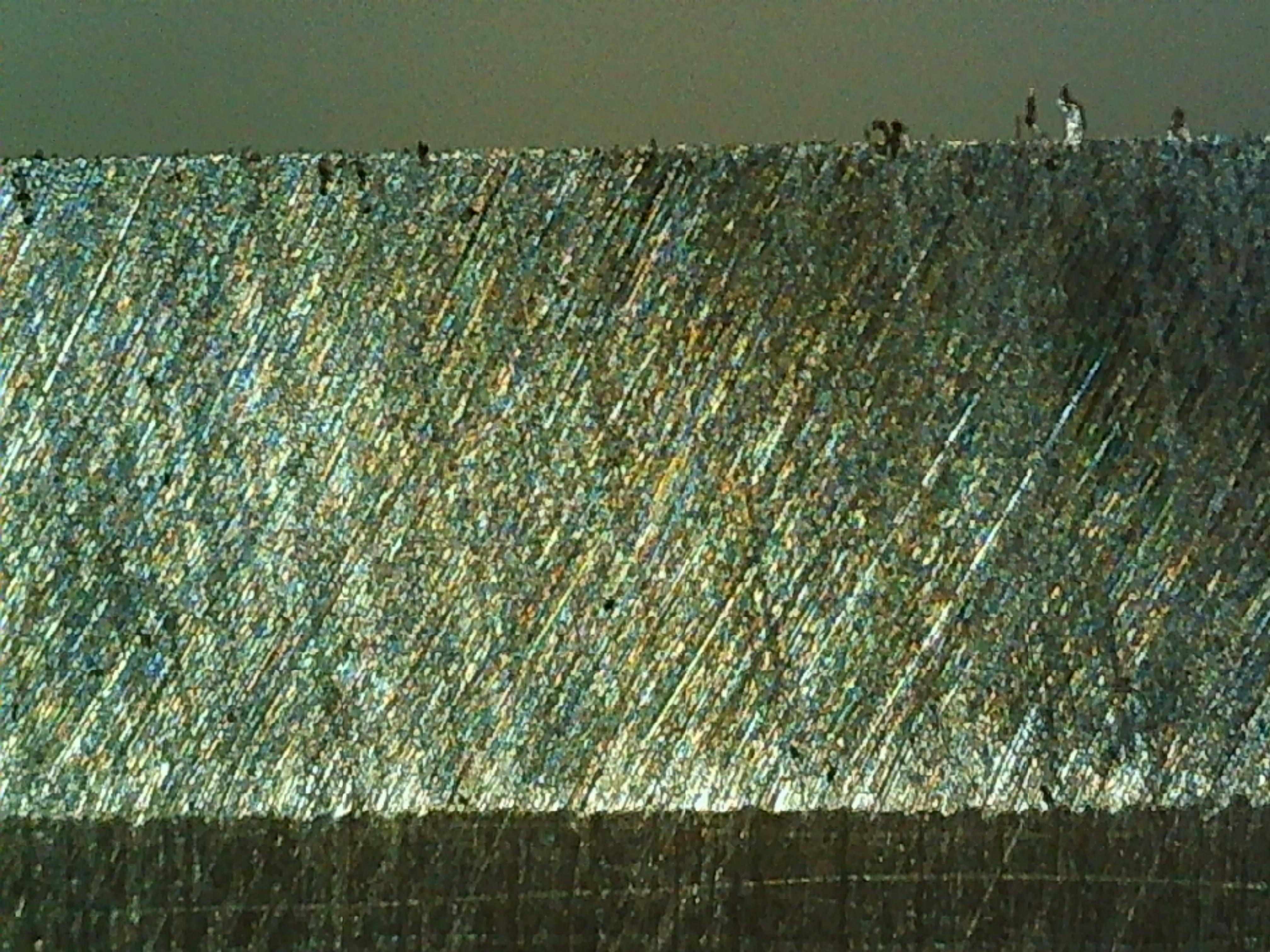

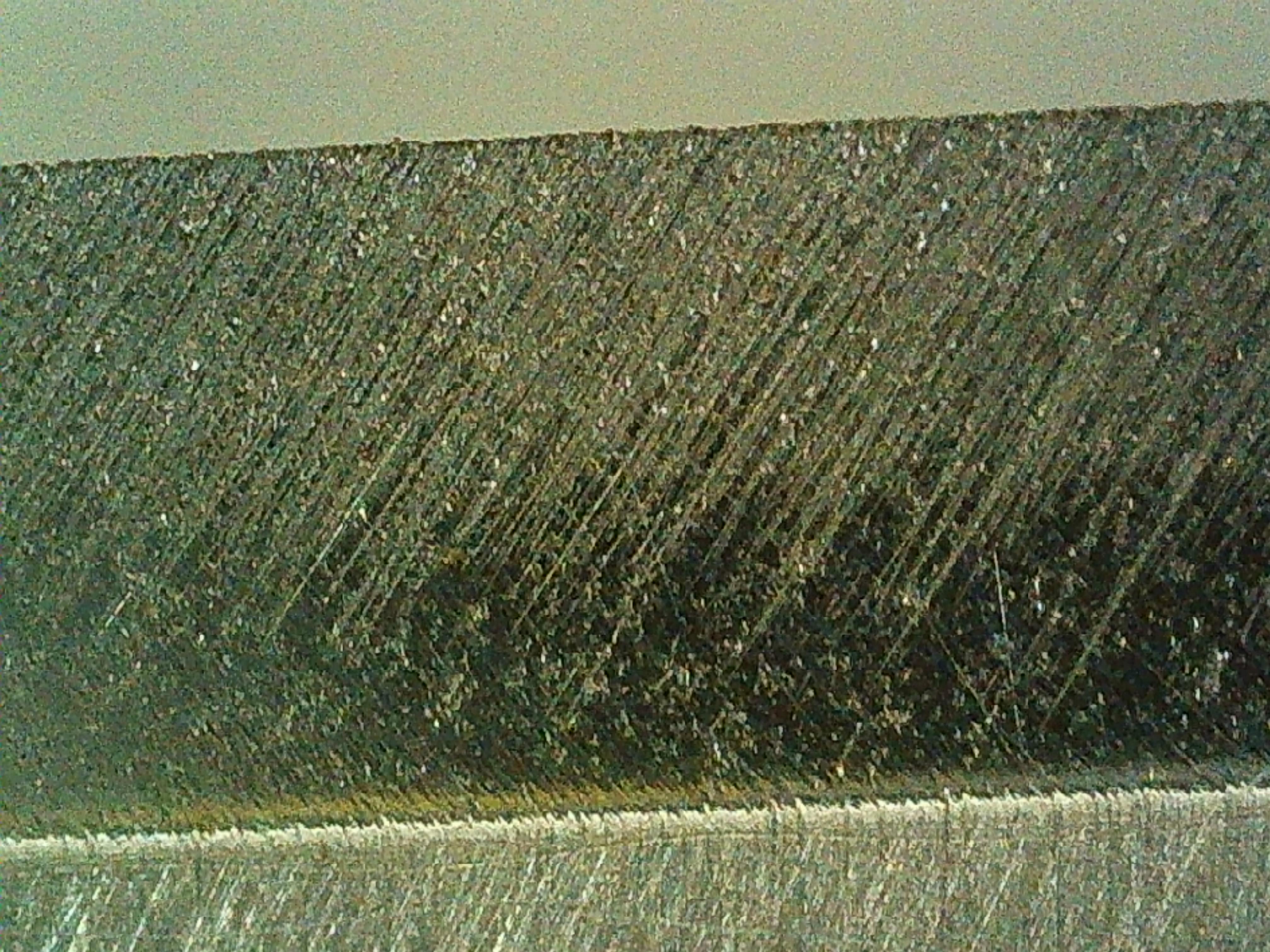

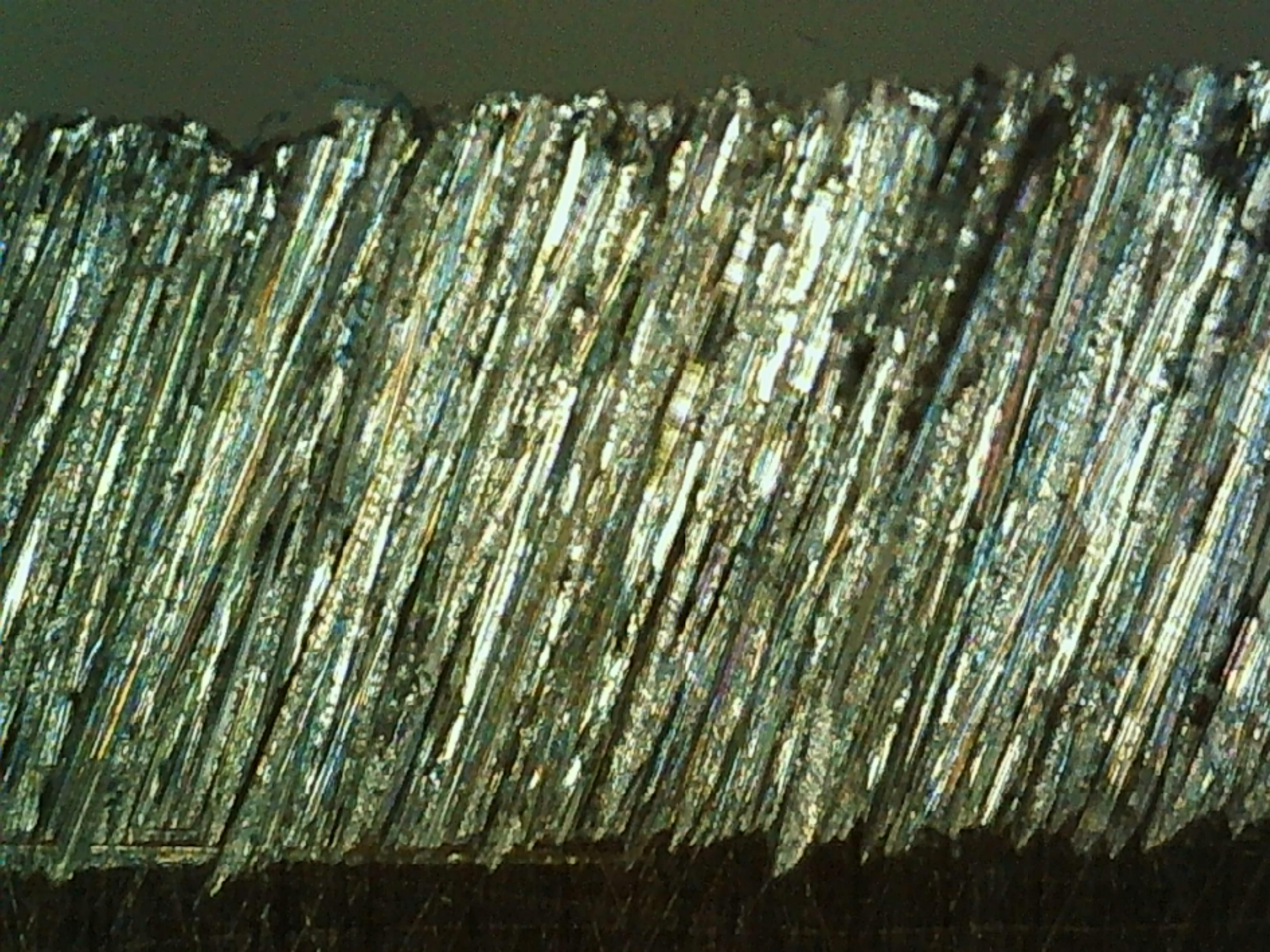

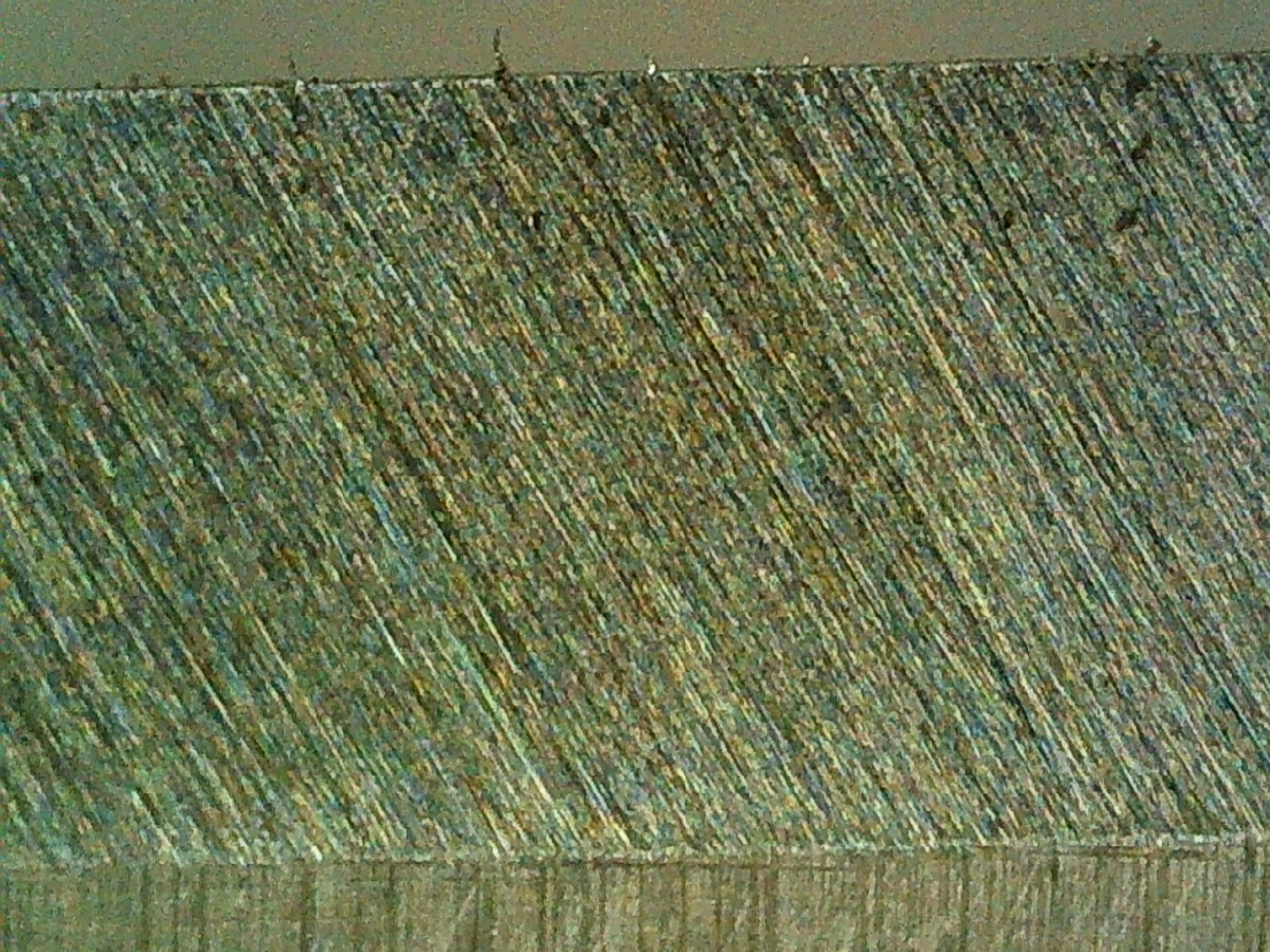

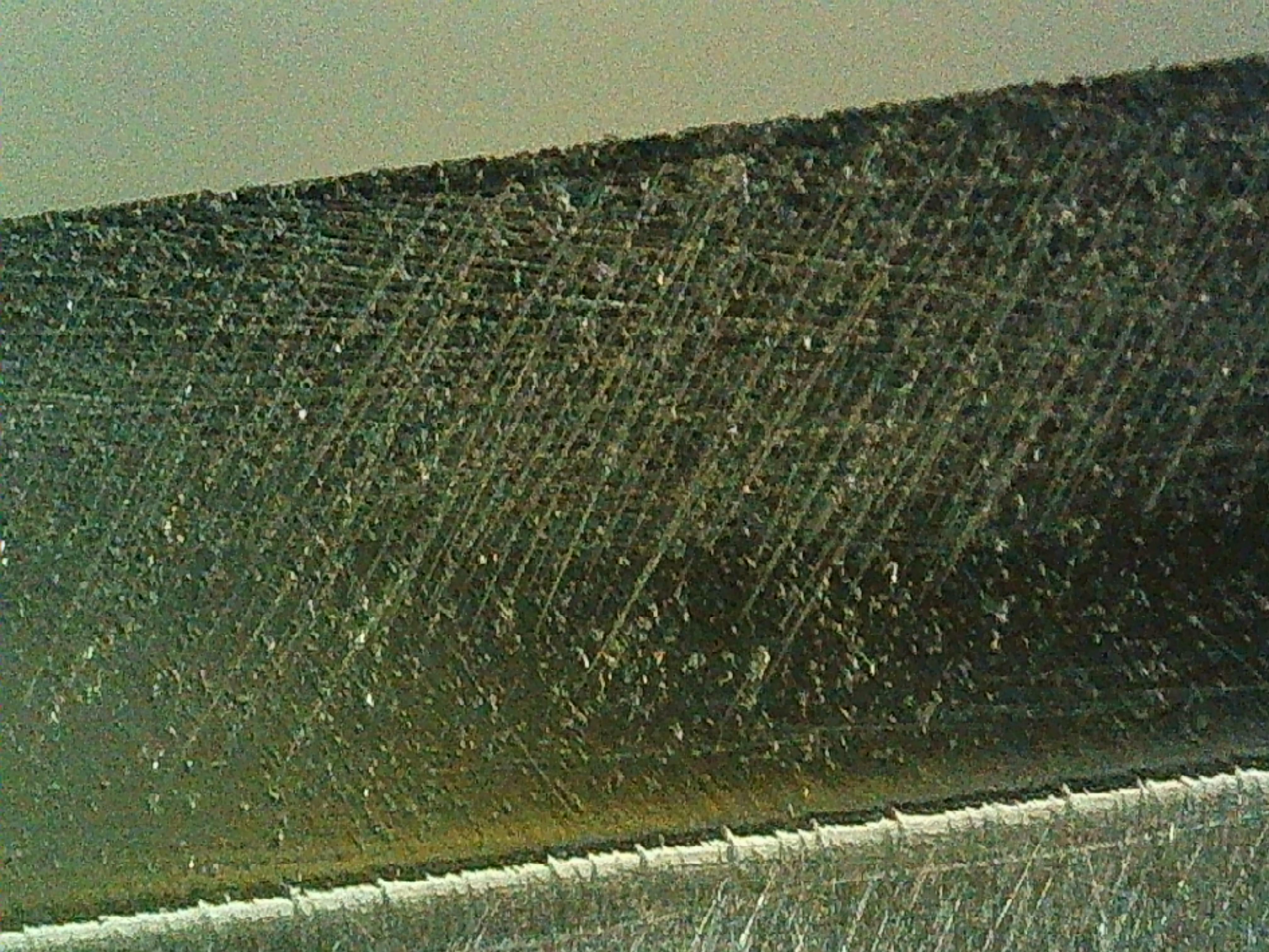

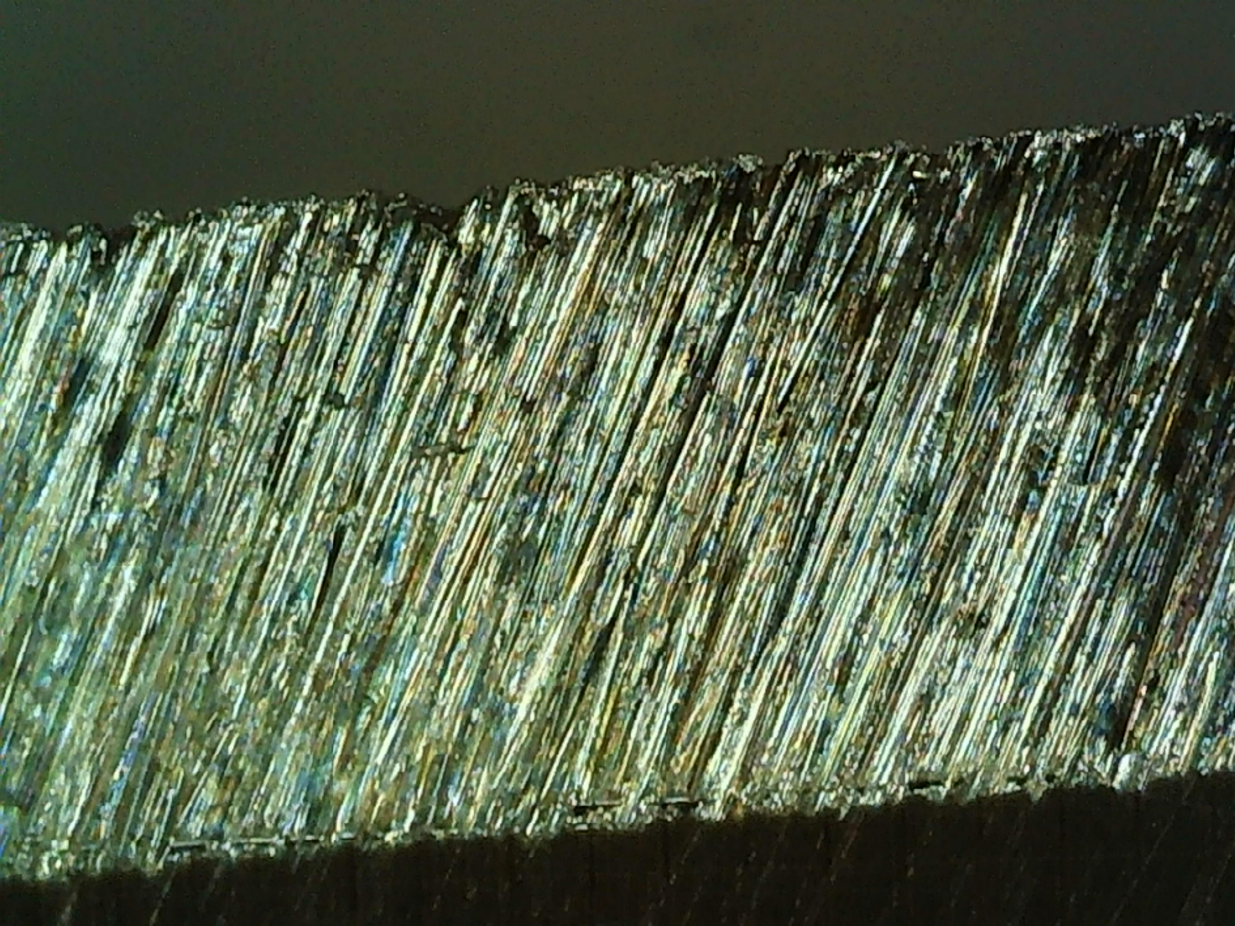

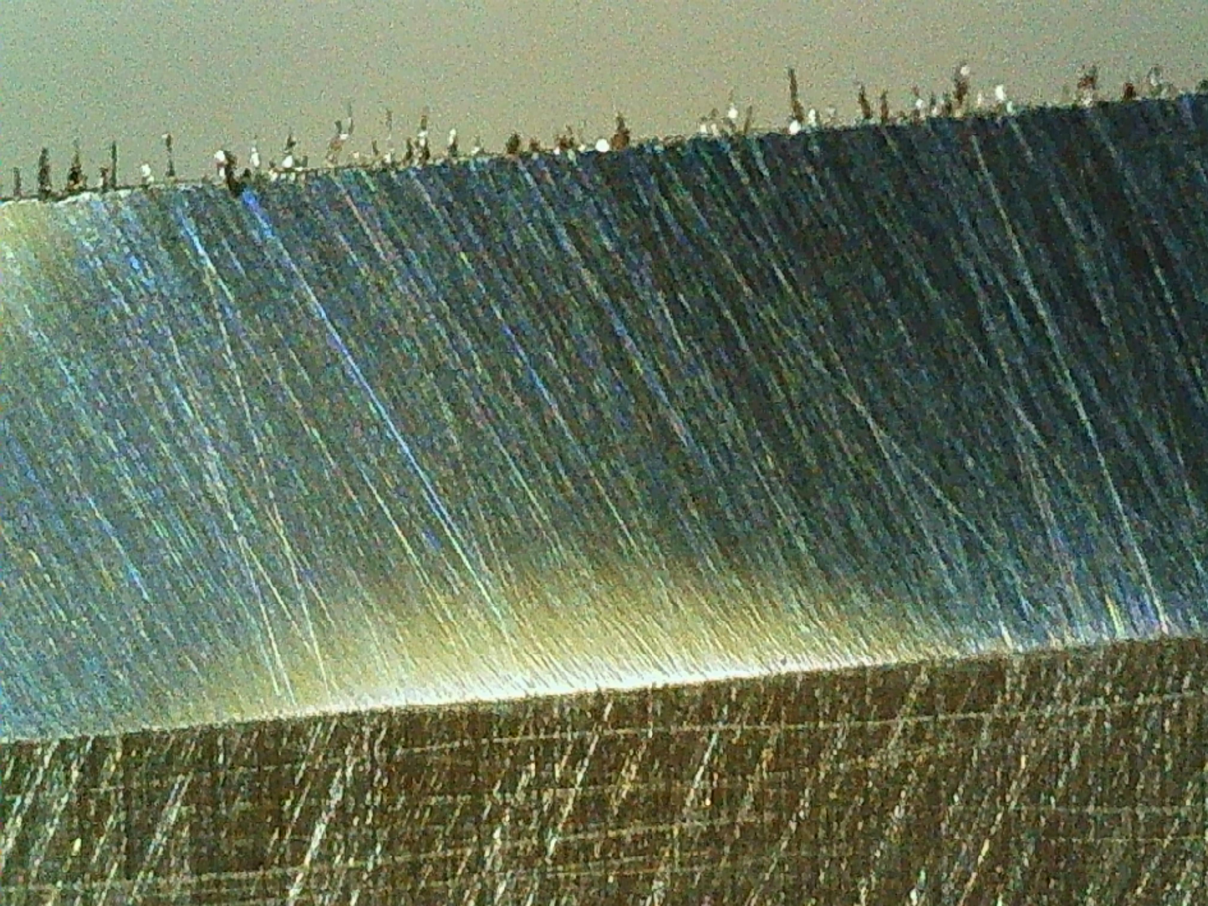

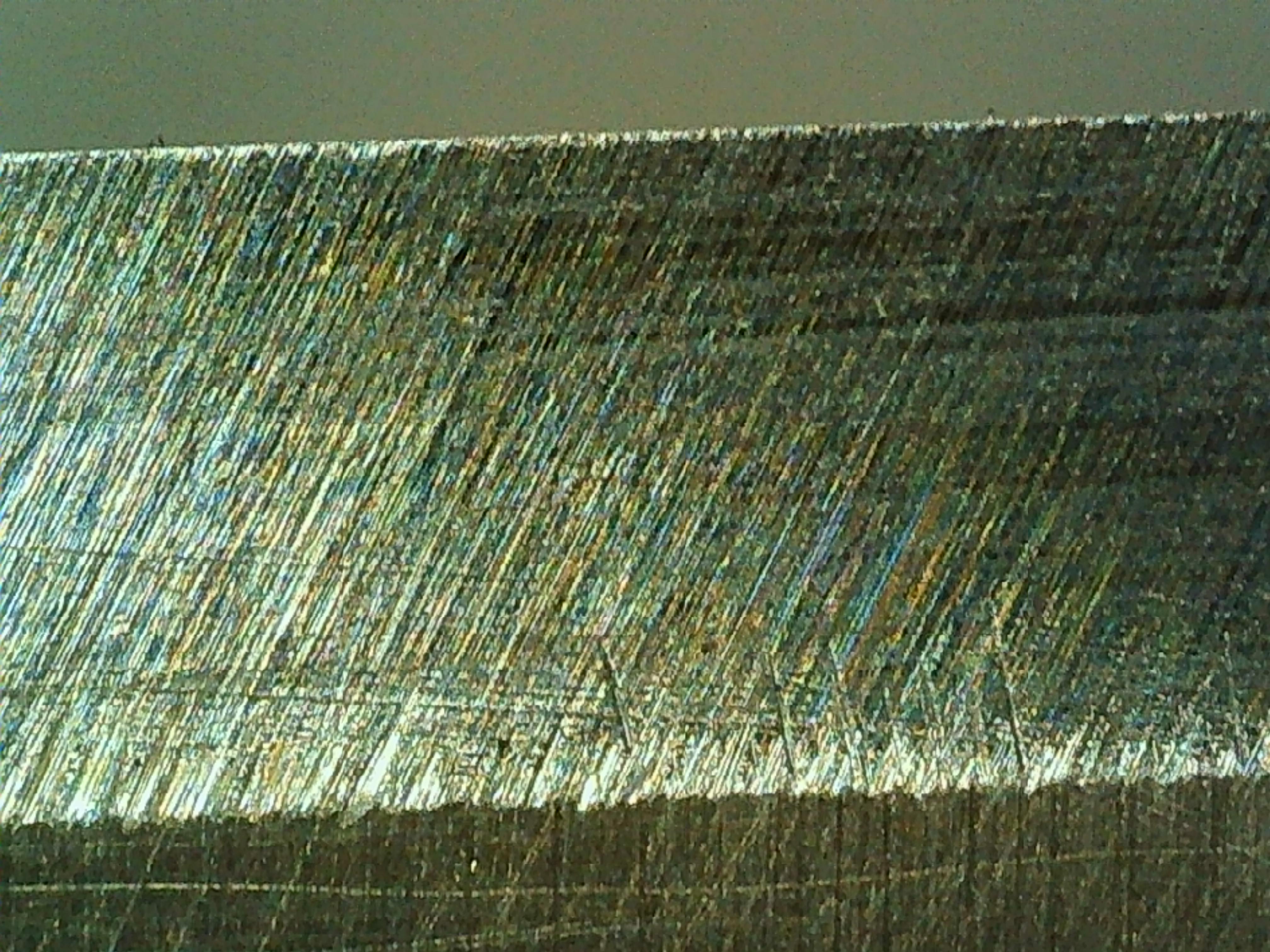

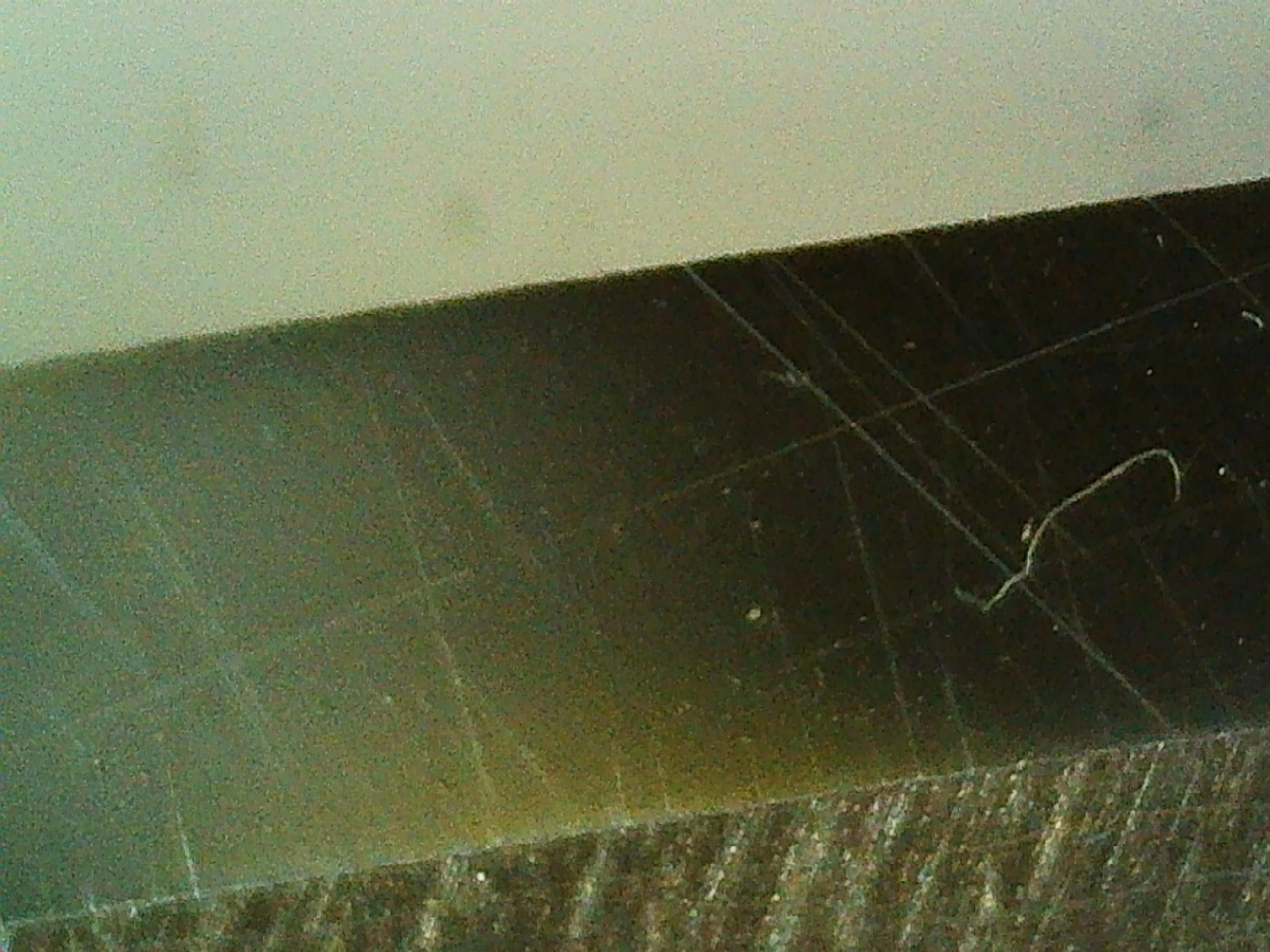

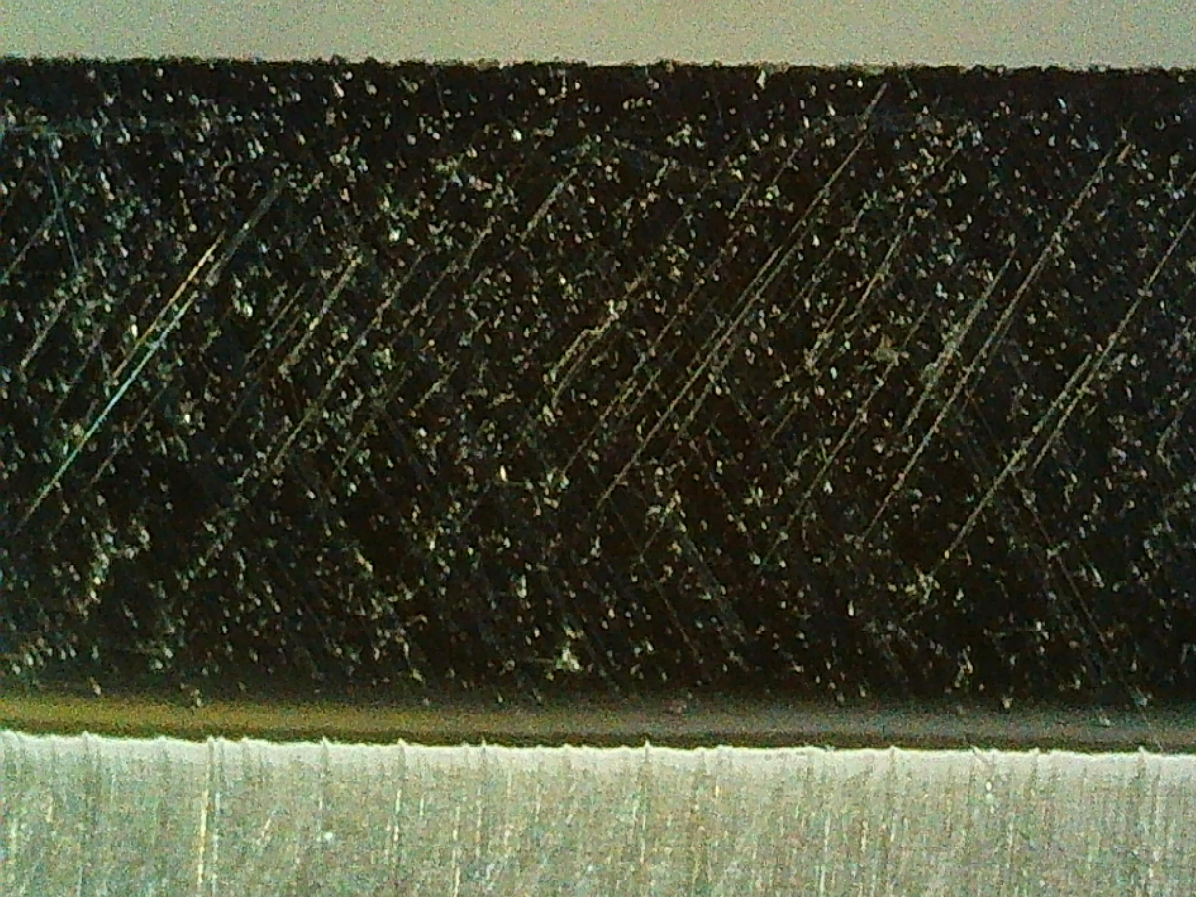

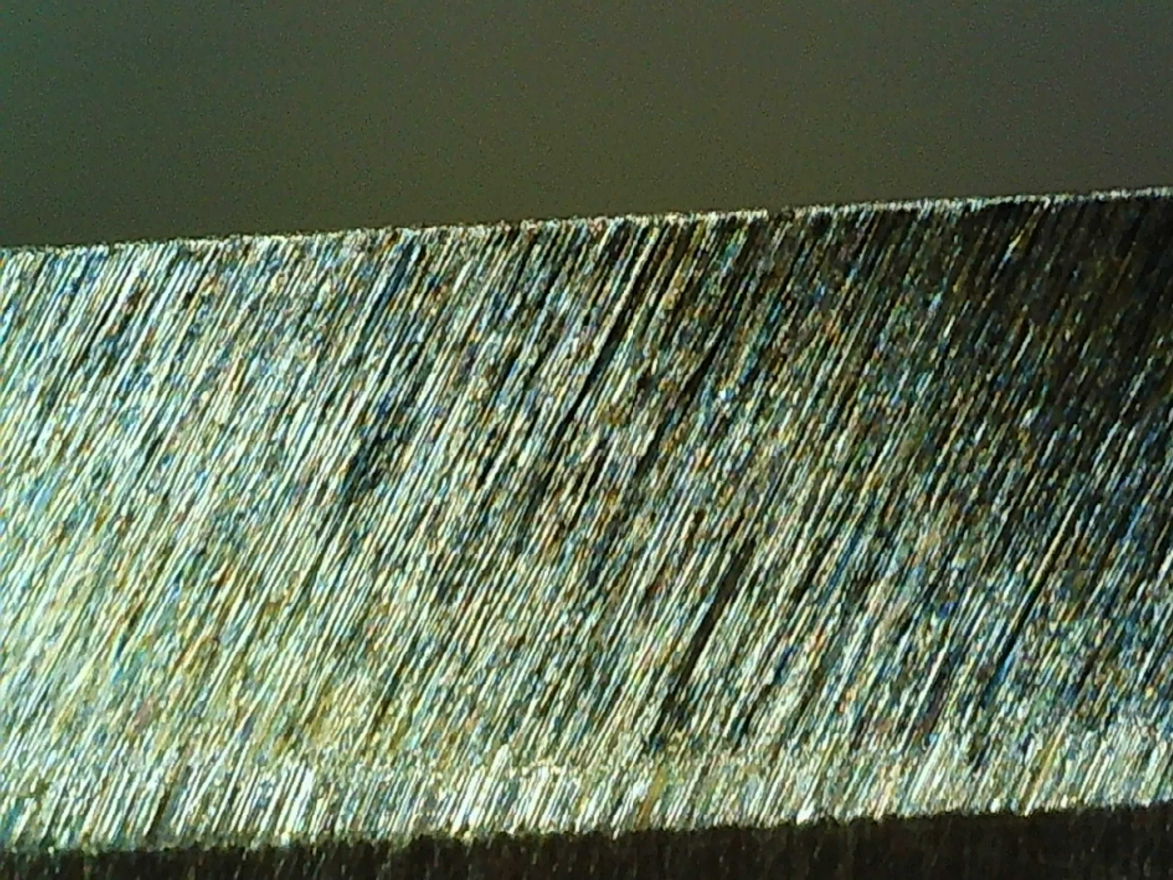

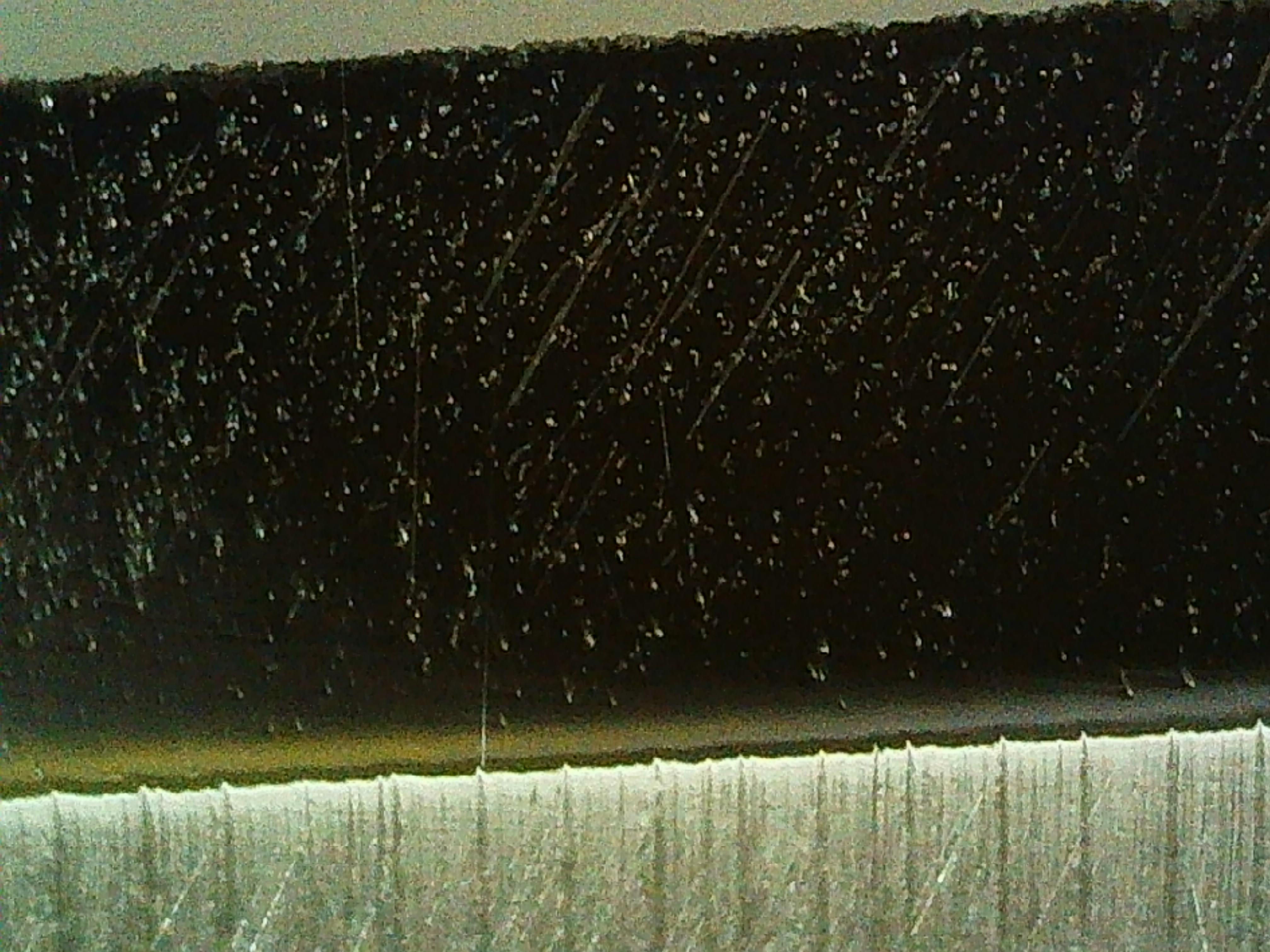

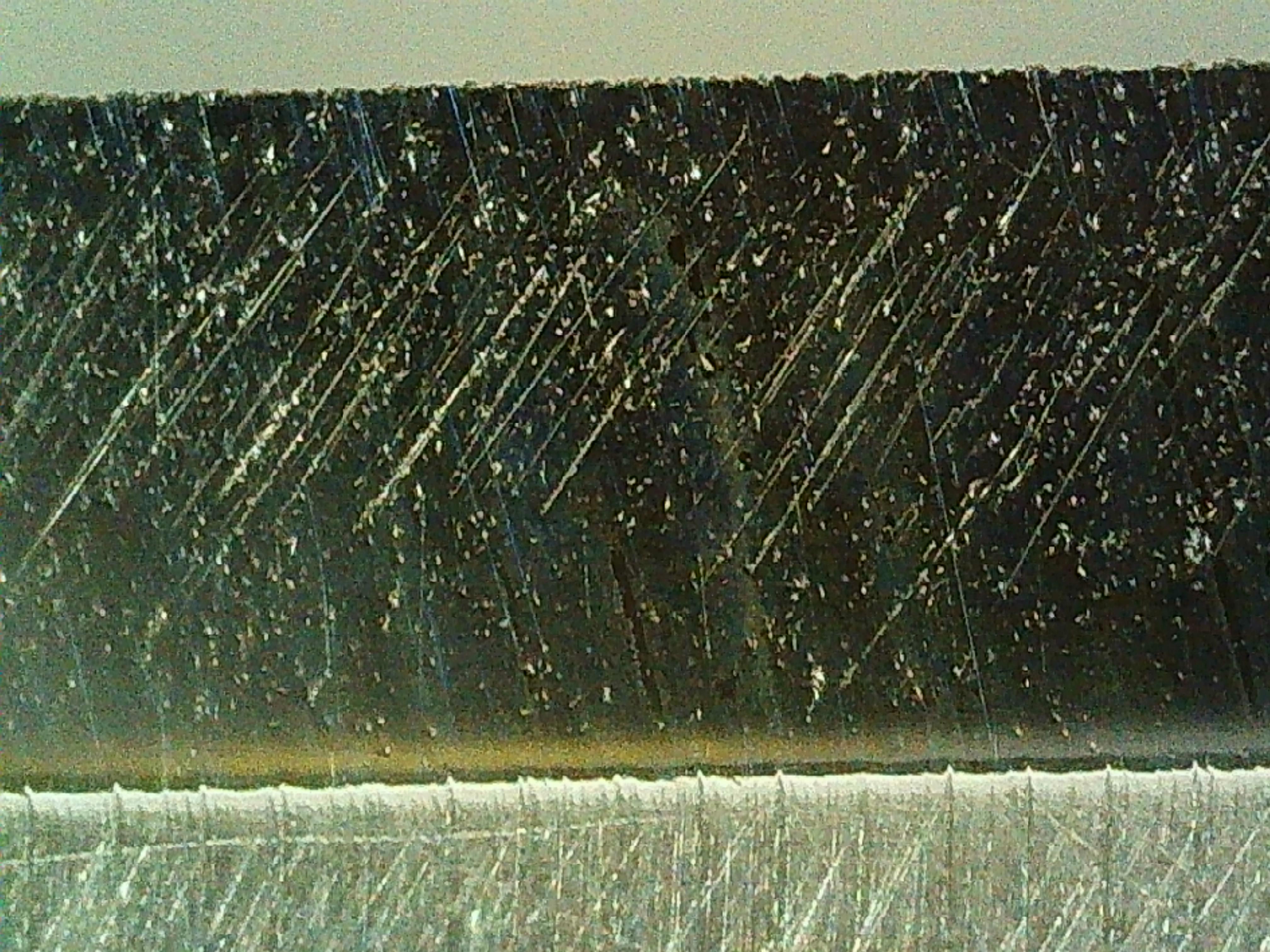

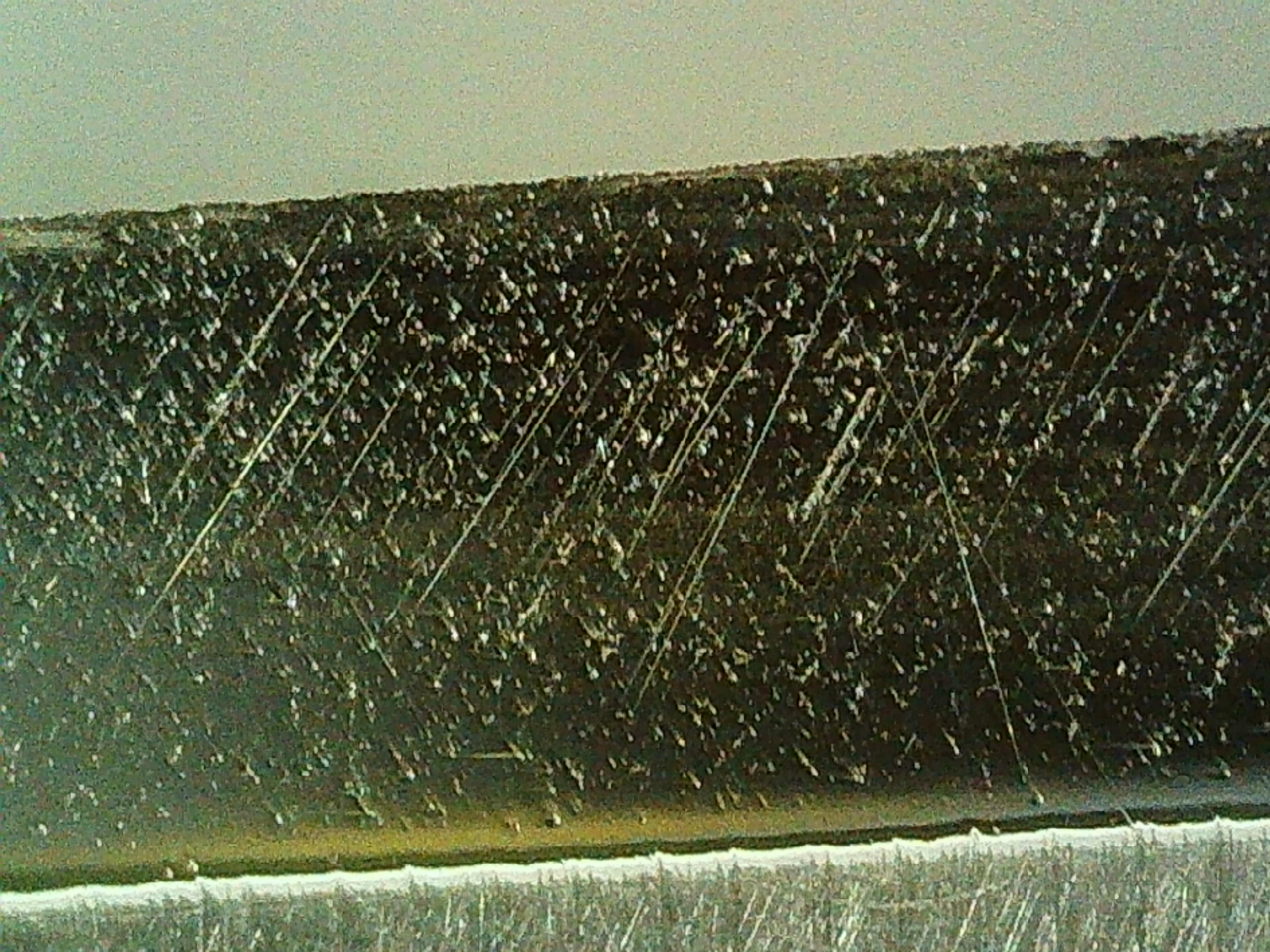

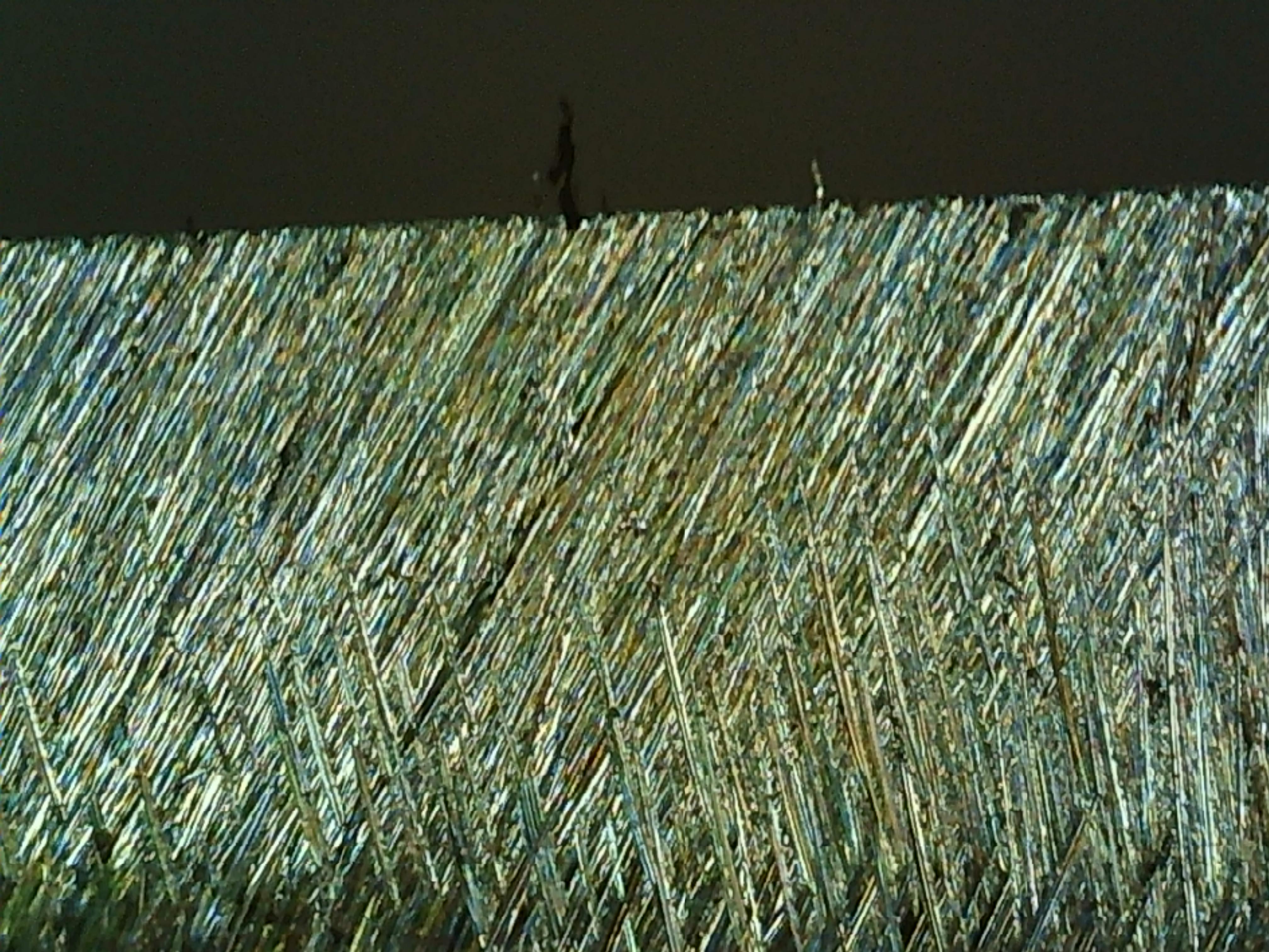

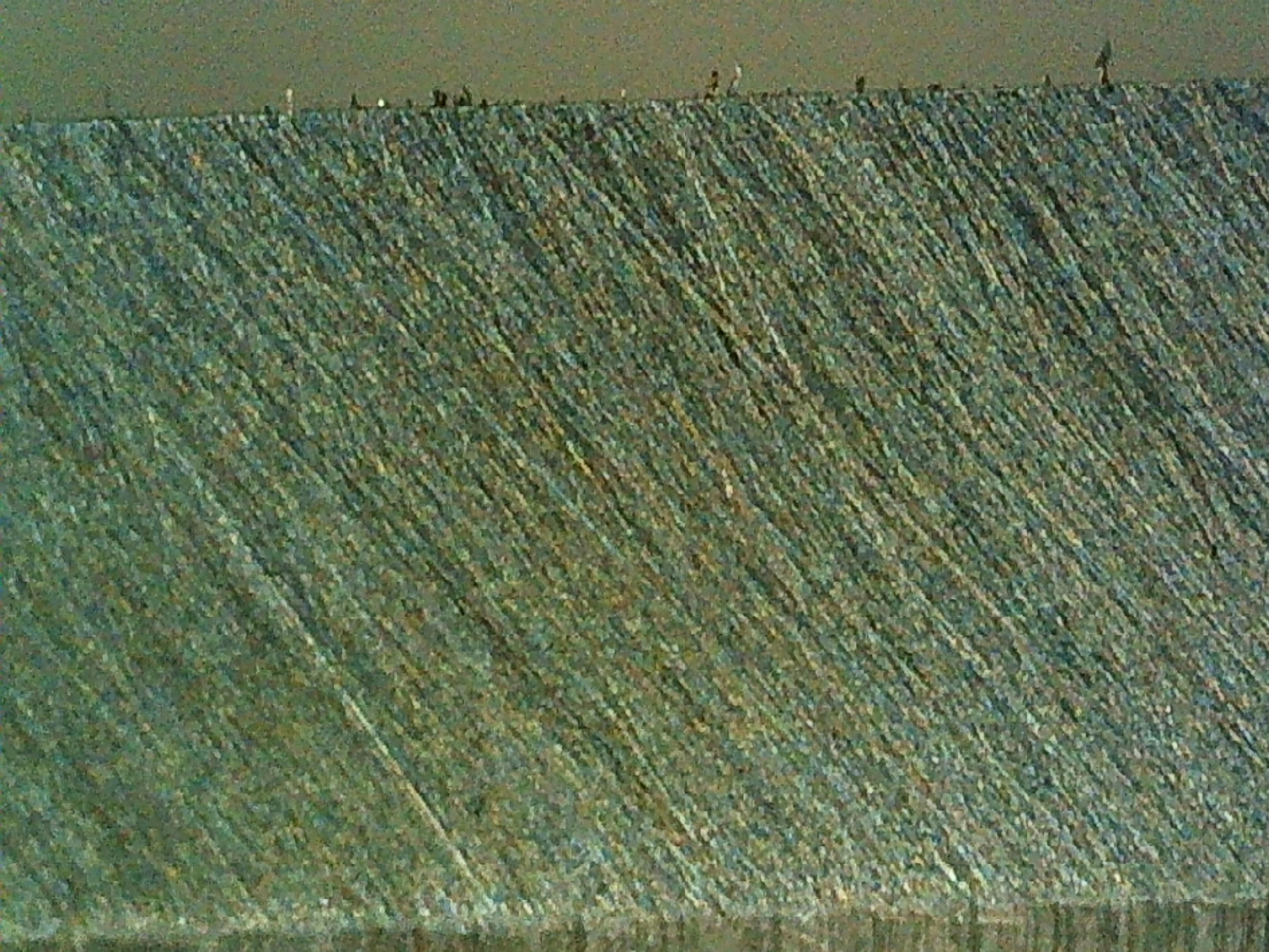

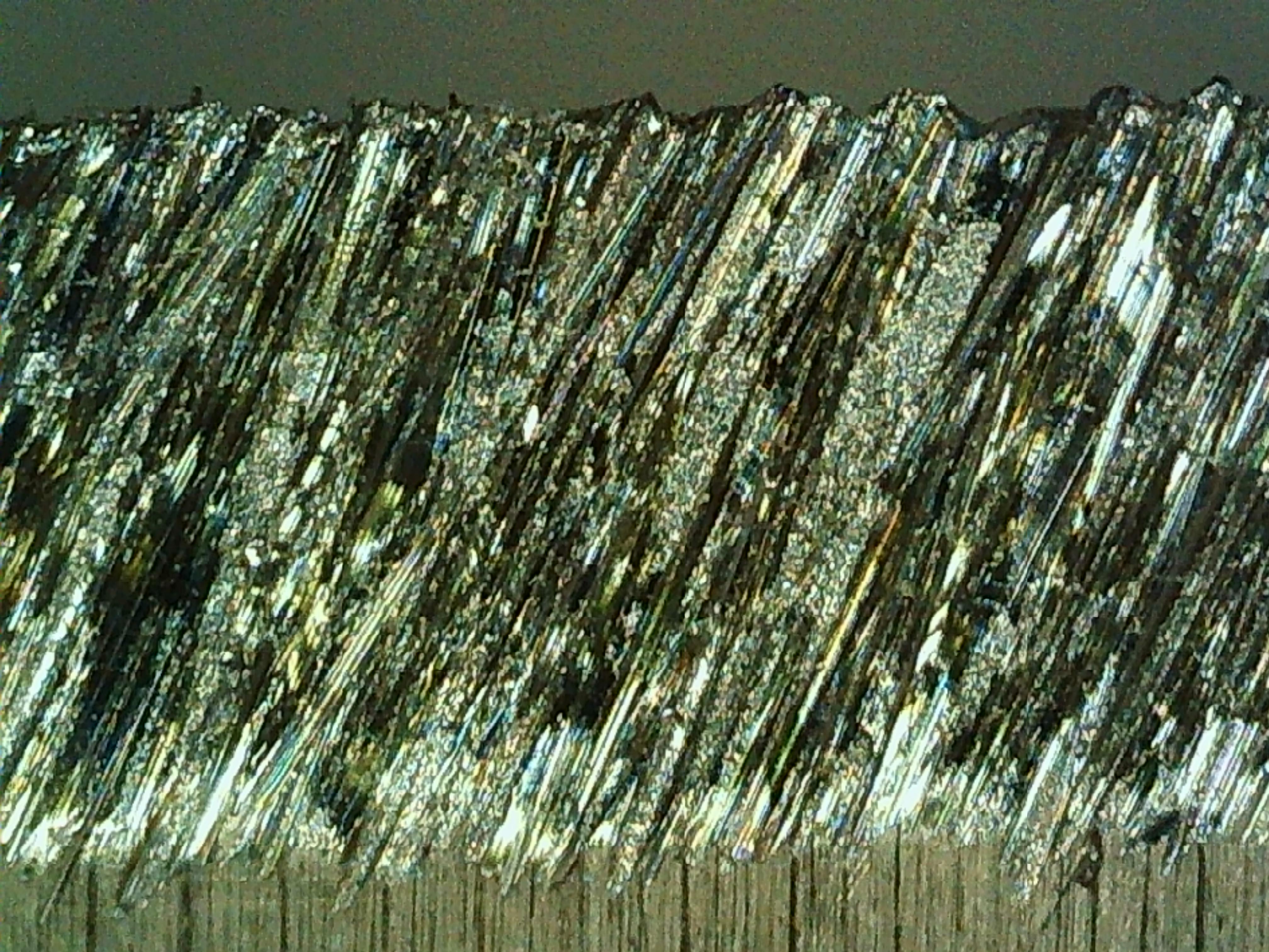

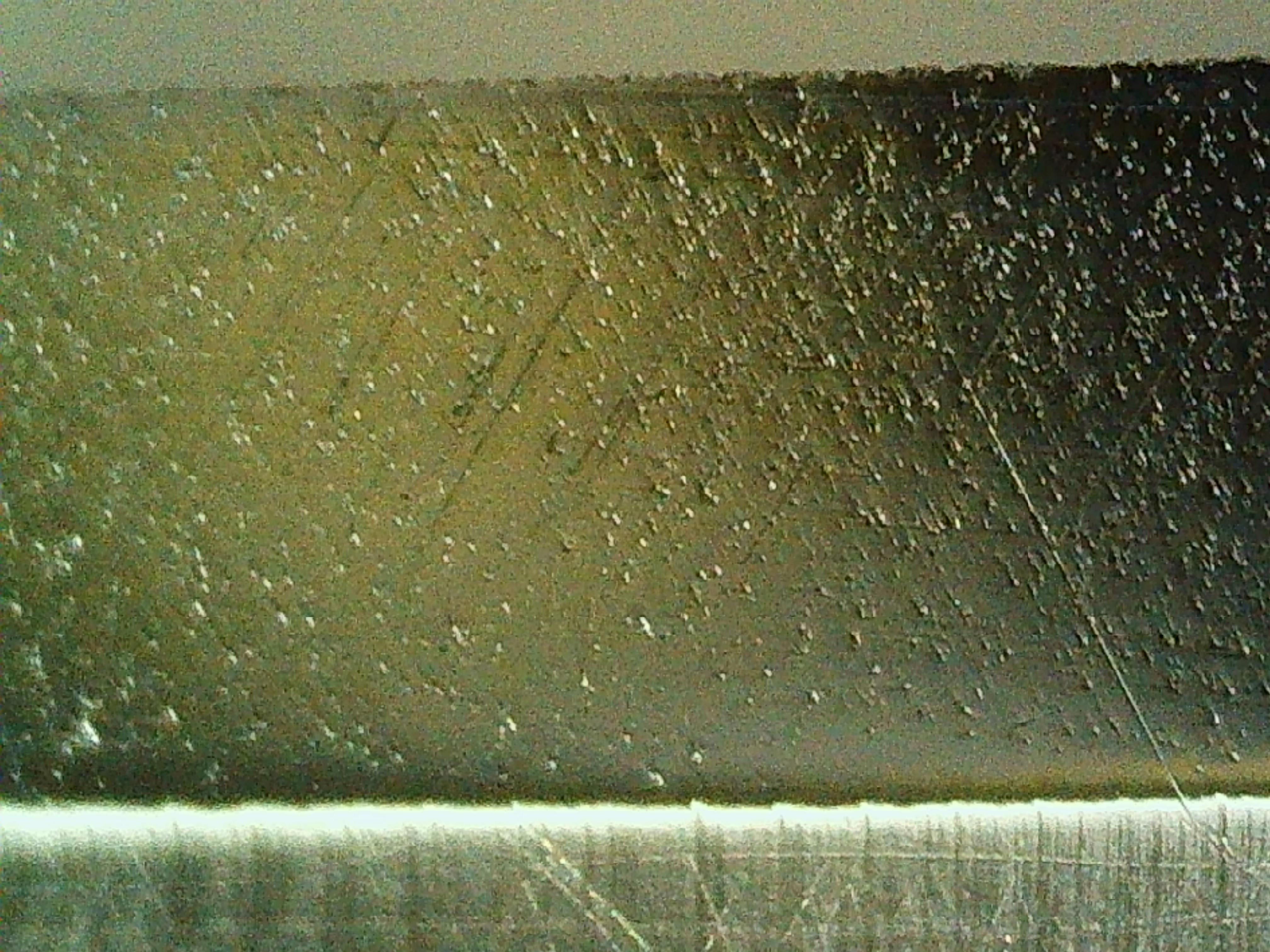

Magnified Image (Broken-In Diamond Stones, M390 Steel)
50 Grit Diamond Stone
50
275
80 Grit Diamond Stone
80
185
100 Grit Diamond Stone
100
150
200 Grit Diamond Stone
200
125
400 Grit Diamond Stone
400
75
600 Grit Diamond Stone
600
40
800 Grit Diamond Stone
800
30
30 Micron Diamond Lapping Film
800
30
1000 Grit Diamond Stone
1000
17
15 Micron Diamond Lapping Film
1,200
15
14 Micron Diamond Paste
1,300
14
1500 Grit Diamond Stone
1,500
12
10 Micron Diamond Paste
1,900
10
2200 Grit Diamond Stone
2,200
9
9 Micron Diamond Lapping Film
2,200
9
3000 Grit Diamond Stone
3,000
6
6 Micron Diamond Lapping Film
3,000
6
5 Micron Diamond Paste
4,000
5
4 Micron Diamond Emulsion
5,000
4
3.5 Micron Diamond Paste
6,500
3.5
3 Micron Diamond Lapping Film
7,000
3
2 Micron Diamond Paste
10,000
2
1.5 Micron Diamond Lapping Film
13,000
1.5
1 Micron Diamond Lapping Film
14,000
1
1 Micron Diamond Paste / Emulsion
14,000
1
0.5 Micron Diamond Paste / Emulsion
50,000
0.5
0.25 Micron Polycrystalline Diamond Emulsion by Gunny Juice
100,000
0.25
0.1 Micron Diamond Lapping Film
250,000
0.1
0.1. Micron Polycrystalline Diamond Emulsion by Gunny Juice
250,000
0.1
