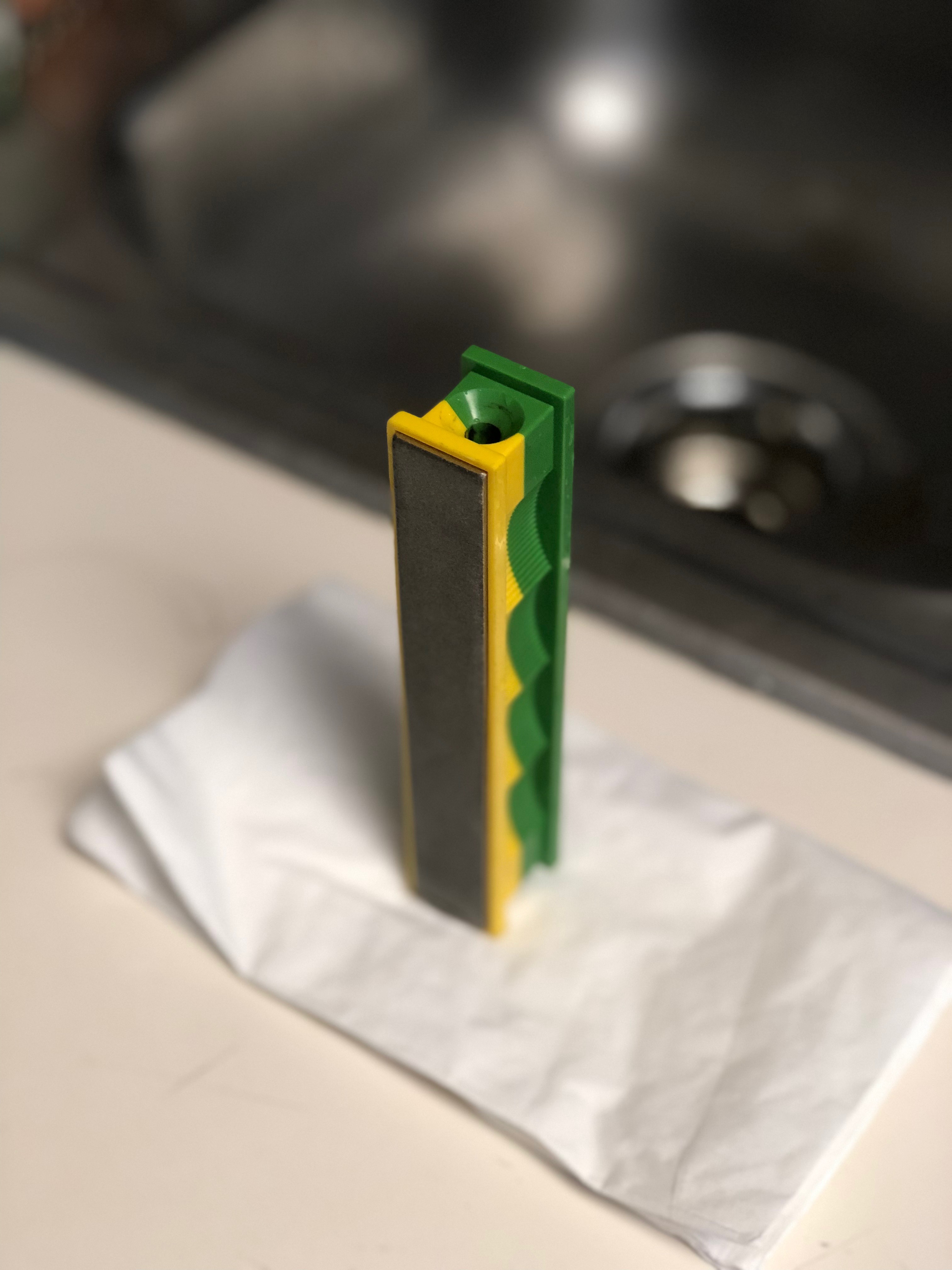

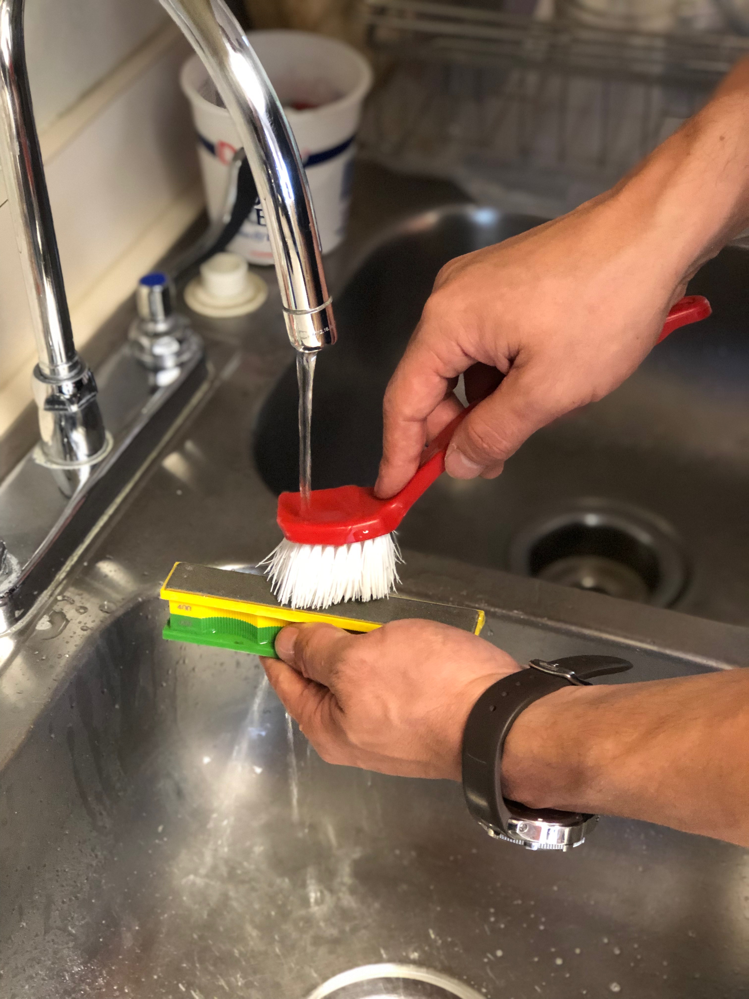

To keep your Diamond Stones in proper working order, they do require periodic cleaning (we recommend every 25 sharpening sessions or so). For quick, on the spot cleaning, a little Windex or rubbing alcohol and a paper towel does the trick. For deeper cleanings, all you need is a toothbrush, some dish soap, and warm water. Simply scrub the stones with the toothbrush and soap, then rinse with warm water and stand on end to dry overnight.
If your Diamond Stones are truly clogged up, you can either soak them in some white vinegar for about 10 minutes to loosen all of the filings and debris and then follow the above procedure, or you can use an ultra sonic cleaner on the lowest settings.

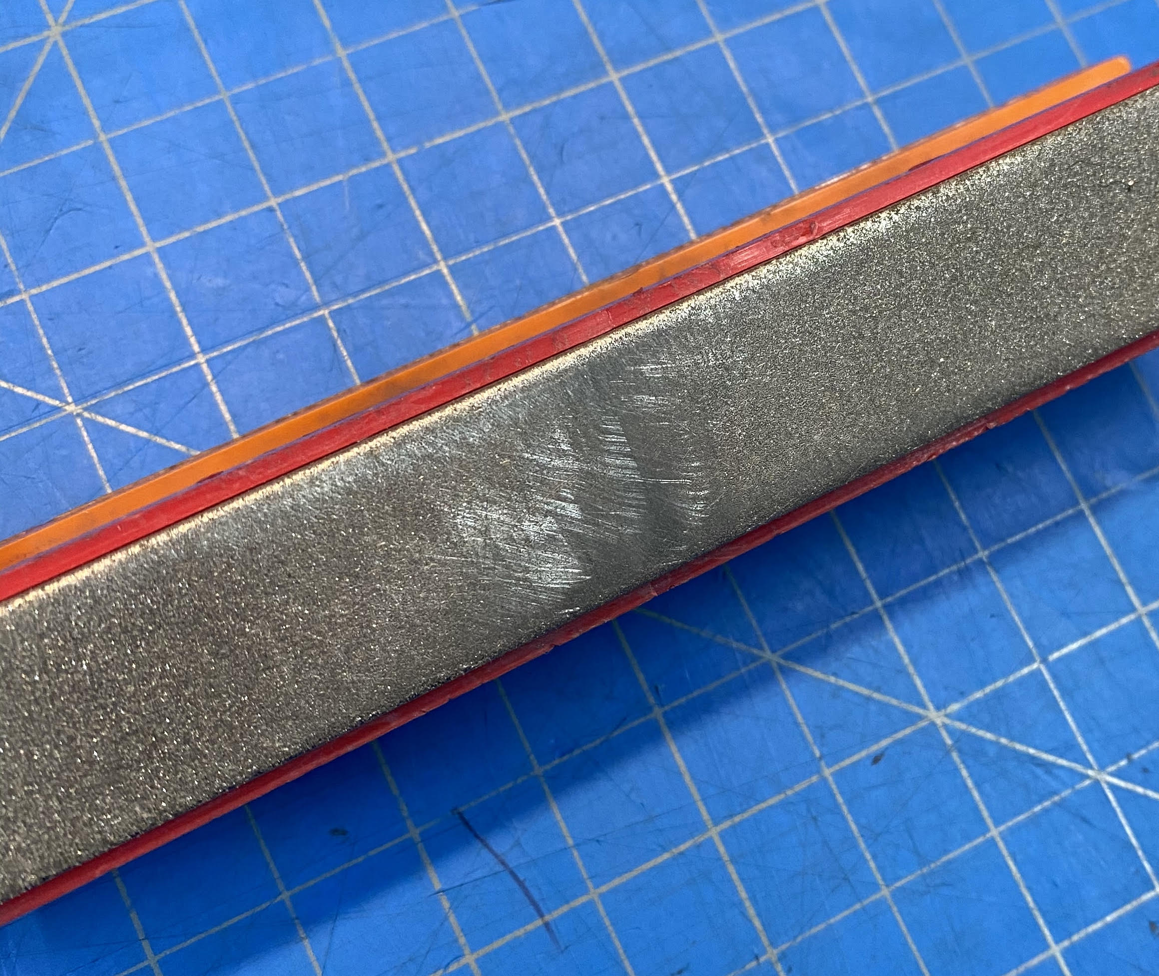

Eventually, Diamond Stones do wear out. You can tell that they have worn out when you start to see bald spots where the bare aluminum platen shows underneath the surface of the stones. This most often happens along the edge of the stones and in the middle where your stones are most heavily used. Once you see this, it's time to replace your stones as they will no longer be able to do their job. Normal wear on Diamond Stones is not covered under warranty.
