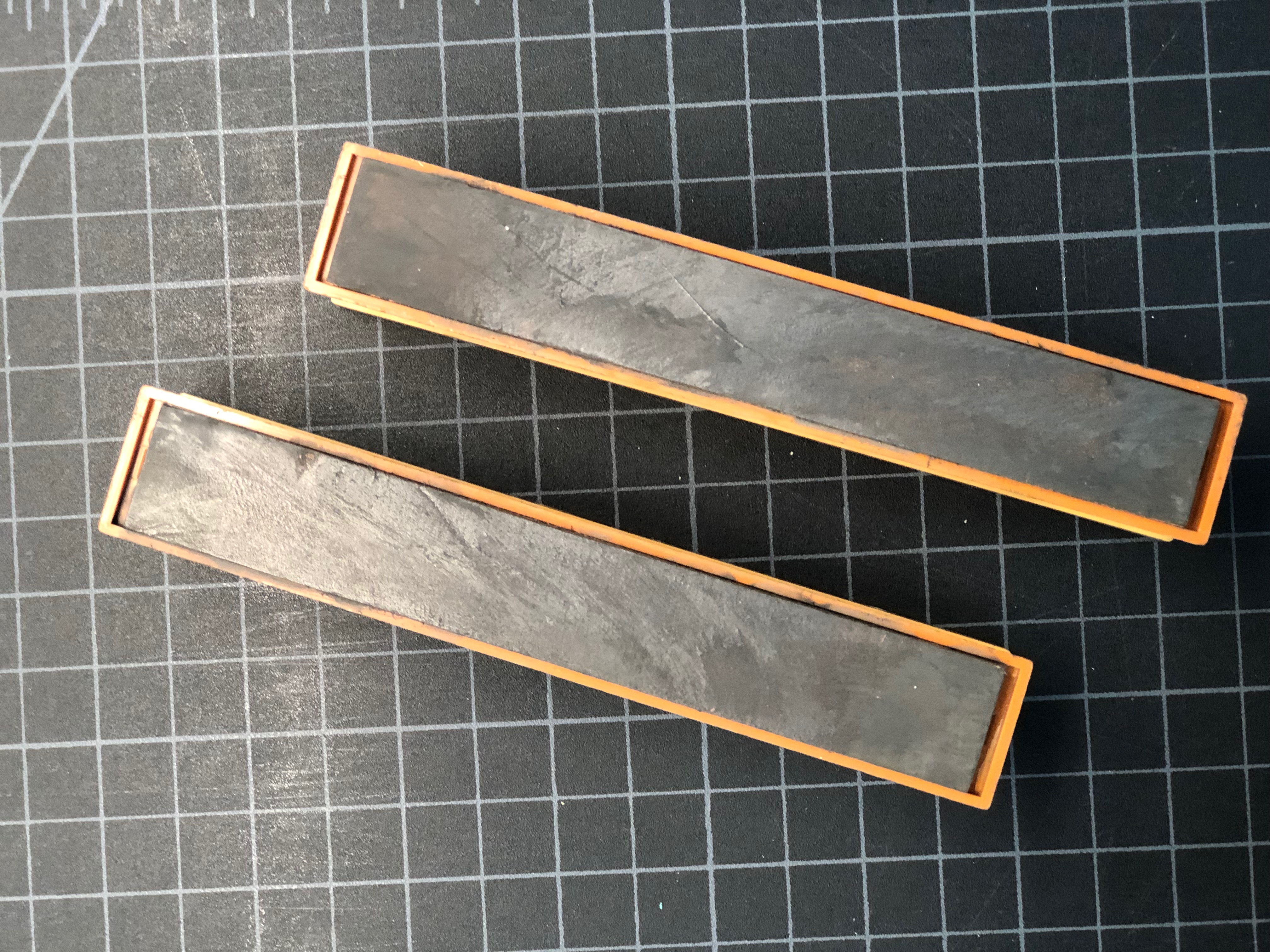

Cleaned strop (top) vs. uncleaned strop (bottom), for comparison
After the Strops have been cleaned, reapply stropping compound to them.
